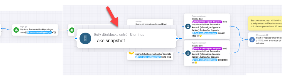

@Peter_Kalrsson im missing the snapshot flowcard call in the report. can you run that and send a new one?
@martijnpoppen
Off course, here you go:
e252326c-a68f-4ffe-91cc-34c12e53e883
OK?
@Peter_Kalrsson nope its not there. Can you share your flow?
@martijnpoppen
Really strange :frowning:
Flow working without any problems. Kind of wide, a bit copy and paste, but here you go:
@Peter_Kalrsson but where is the snapshot flowcard?
See example : [APP][Pro] Eufy Security - #5297 by martijnpoppen
Don’t you see it? :wink:
Just kidding.
OMG - so sorry… I missed that little detail.
Working flawless!!!
