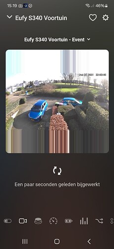

Also the images that are send to Whatsapp from the event (not a snapshot) are still older images as you can see in the timestamp on the whatsapp image and the send date to whatsapp
Here are some examples and things to compare.
This is with all camera’s and doorbell the same issue, all old images.
Thanks again.
@Heula can you see if the image in the device itself also shows a old image? (long press on the device). and did you have that issue already before the test version? If not can you check the live version to compare?
you say they trigger twice, but i’m not seeing that in your timeline and whatsapp
Yes, the device itself also shows an old image.
I have this issue for a long time, mentioned that back than already.
I ended up leaving it be and got interested again with the snapshot option.
The issue is with live and test version.

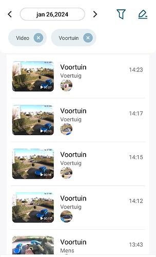

In the Homey notifications, first screenshot you see multiple notifications in the same minute.
If you look at the Eufy notifications itself it is only once in that minute.
I just saw a difference there, maybe it is like it should be?
@Heula but it’s the on and off event right? so that’s correct. Don’t see any difference to be honest :see_no_evil:
It’s strange. Can you send a report after a new notification? Maybe something goes wrong with the image retrieval
Edit: only double event in the same minute are the vehicle and person which i also see in the eufy timeline
You are right, it is the on and off event. I totally missed the on / off text :man_facepalming:.

@Heula please go to your camera settings and put your notification settings to include thumbnail (in the Eufy app on your phone)

I had these settings disabled on purpose because it causing a huge delay.
I have enabled the setting on the cameras but not on my doorbell for the delay reason.
I have a few new images in my whatsapp so it seems that this is working now.
Keep you posted when I can tell for sure.
Thanks.
@Heula yeah without the picture in the notification Homey will be unable to get the picture
