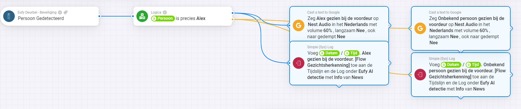

This is the whole flow. When a person is not recognized than Google says unknown person seen at the front door.
That is all I hear lately. :wink:
@Heula yeah so only person recongition is not working in Homey, but the actual event is :slight_smile:

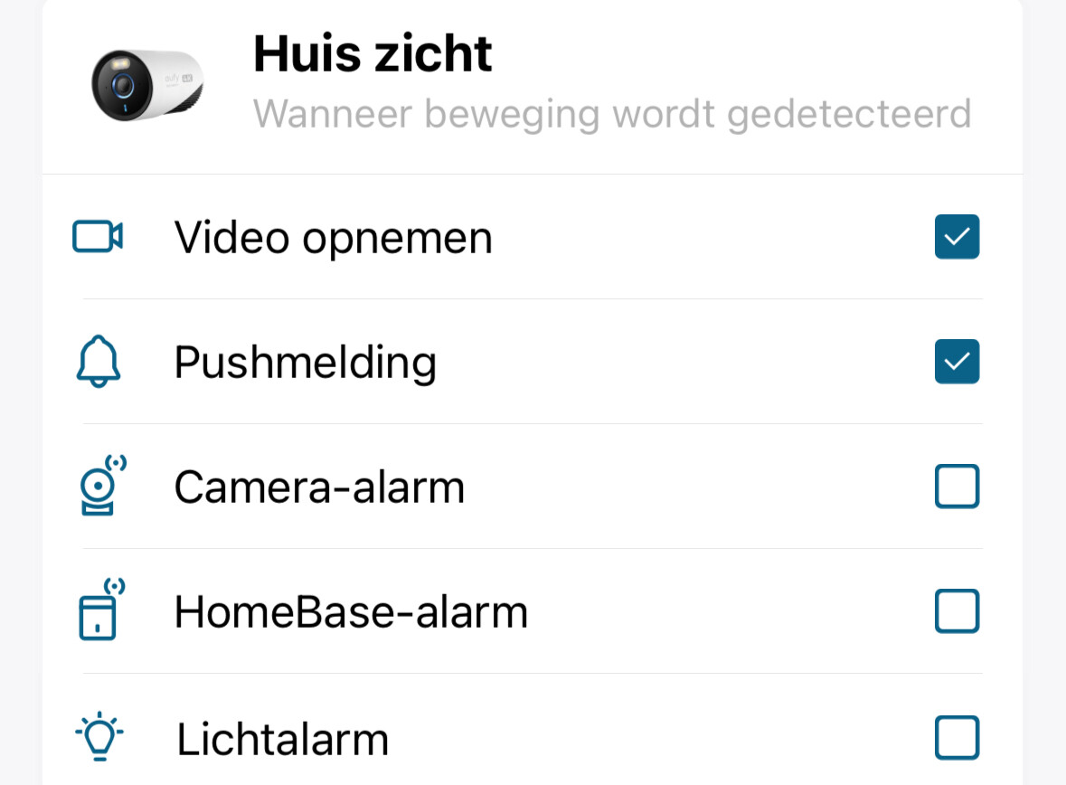

I have checked this and I have those setting activated, but no reaction in Homey.

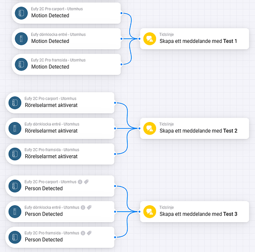

  1. Motion/Motion alarm/person detected cards no longer triggered in Homey. Fully working in the Eufy app though (I can see new images arriving). Nothing is triggered:

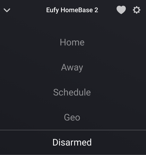

  1. I can see that the Homebase nowadays says “Disarmed” when I’m at home. I am quite confident that this has been “Home” before. I always set “Home” as arm state when arriving home (99.9% through Advanced Flows). As you can see, it says “Home” in the Eufy app - not in Homey though. “Force switch mode notifications (prevent turning off by Eufy” is set to “Yes”. (If I select “Home” in Homey and restart the app, “Disarmed” is selected again.)

Then there’s only the question about arm state left. Do you know why the statuses are not in sync? I believe it should say “Home” in Homey, not “Disarmed”.
