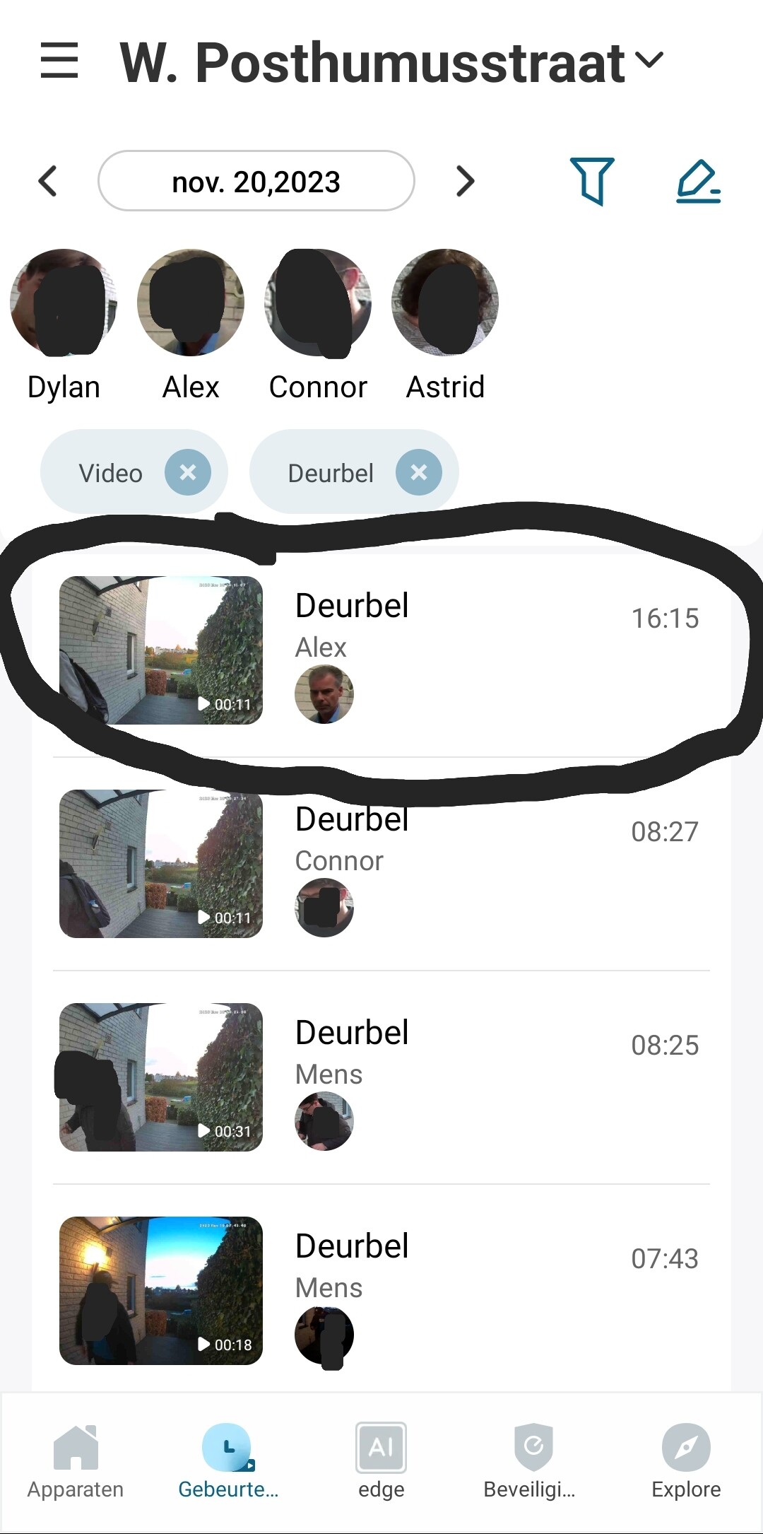

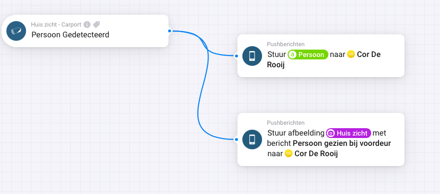

@martijnpoppen I have the same issue with the E330 and E340 cameras.
Eufy see me as a person, but the Flow is not reacting.

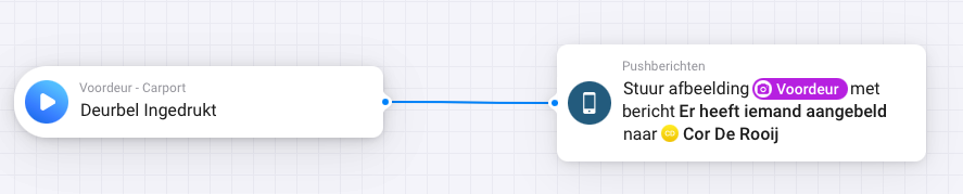

The Doorbell “pressed” send me a thumbnail of an old situation, for sure not the one that you expect.
