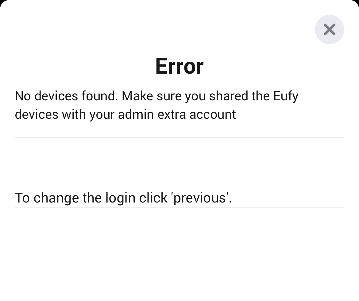

Hello. I’m having trouble adding eufy to Homey. I’m getting to this point and I don’t know what to do next
I created an additional account on eufy as an administrator, but it didn’t help
@Justyn and you did accept the invite? And you selected the correct region? And you used the correct combination of email and password?

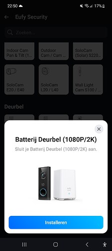

A Homebase is mandatory same as in the Eufy app. The connection to the camera is trough the Homebase.
But it depends on your camera. If you bought a camera without Homebase and set that up in the Eufy app then you probably chose the wrong device in Homey

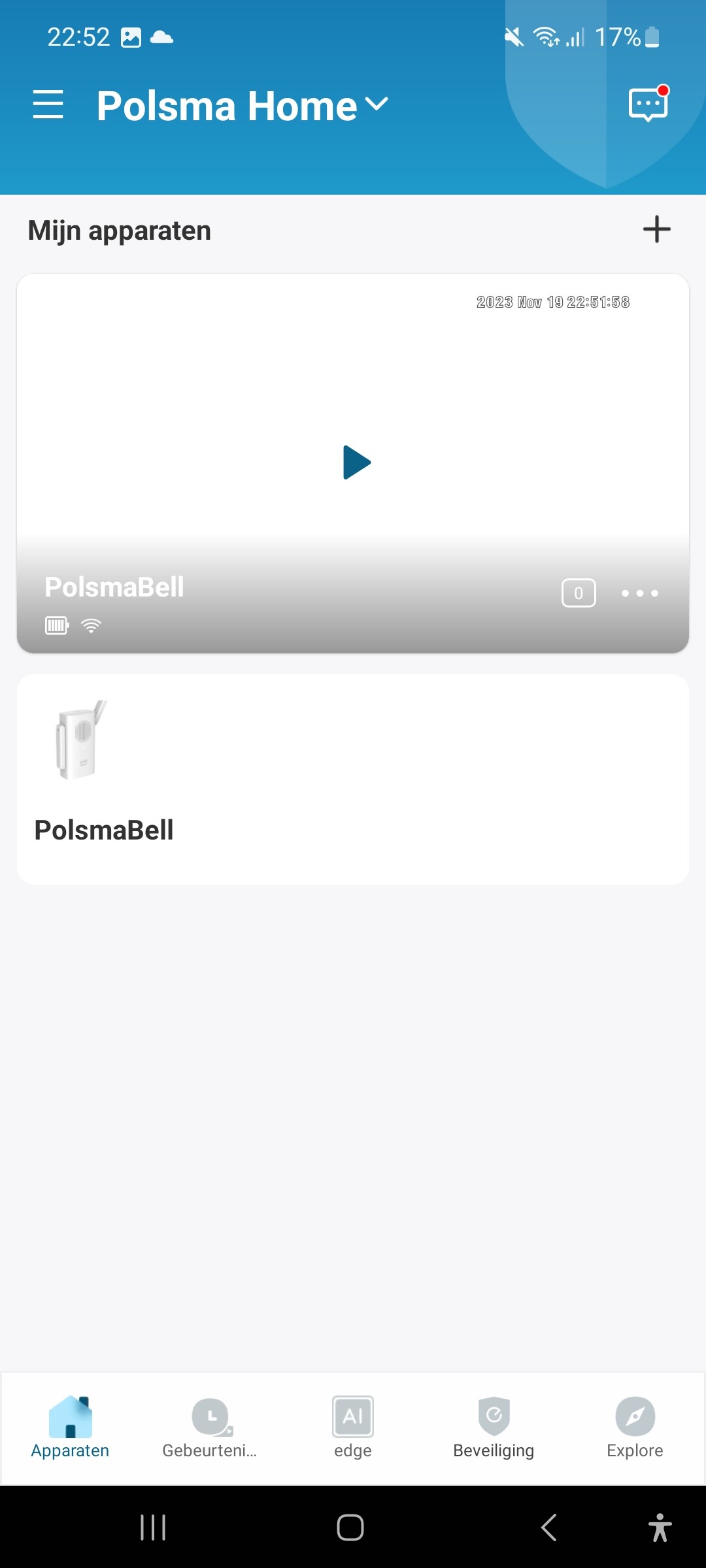

Hi, this time in English.
Ik got a battery 1080p camera doorbell. It looks all setup in the Eufy securtity app.
In Homey i choose the 1080p battery one.
But i guess i need to buy a Homebase still?
