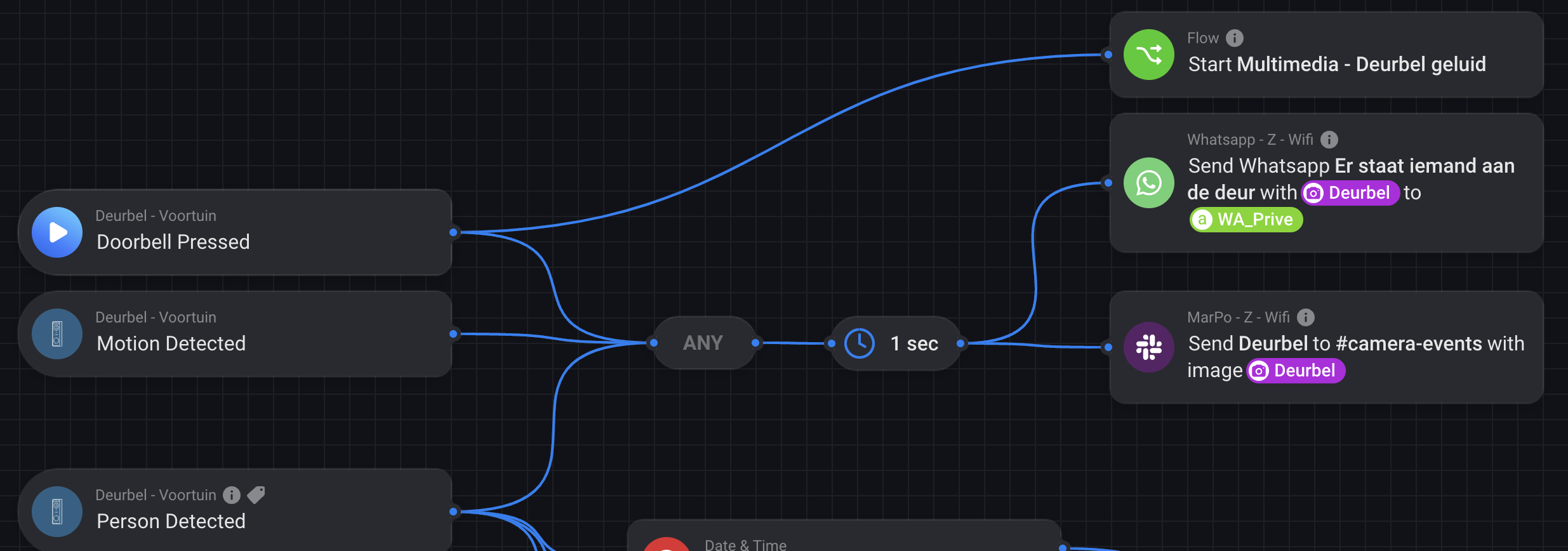

So the correct flow including doorbell rang should be?
@spelevinken sharing my flow as inspiration ![]()
But keep in mind that a doorbell press doesn’t always include a image [APP][Pro] Eufy Security - #4 by martijnpoppen - Apps - Homey Community Forum Q3
I have found out that you get a picture when the doorbell button is pressed, if you set a delay on the card to 4 seconds.
@SunEast only when your doobell detects a person at the same time ![]()
I use “PiPup” which sends an image to the TV when someone presses the doorbell. If I don’t set a delay of 4 seconds, I only get the previous picture on the TV. This is regardless of whether there has been movement at the front. I have a dual battery doorbell.
