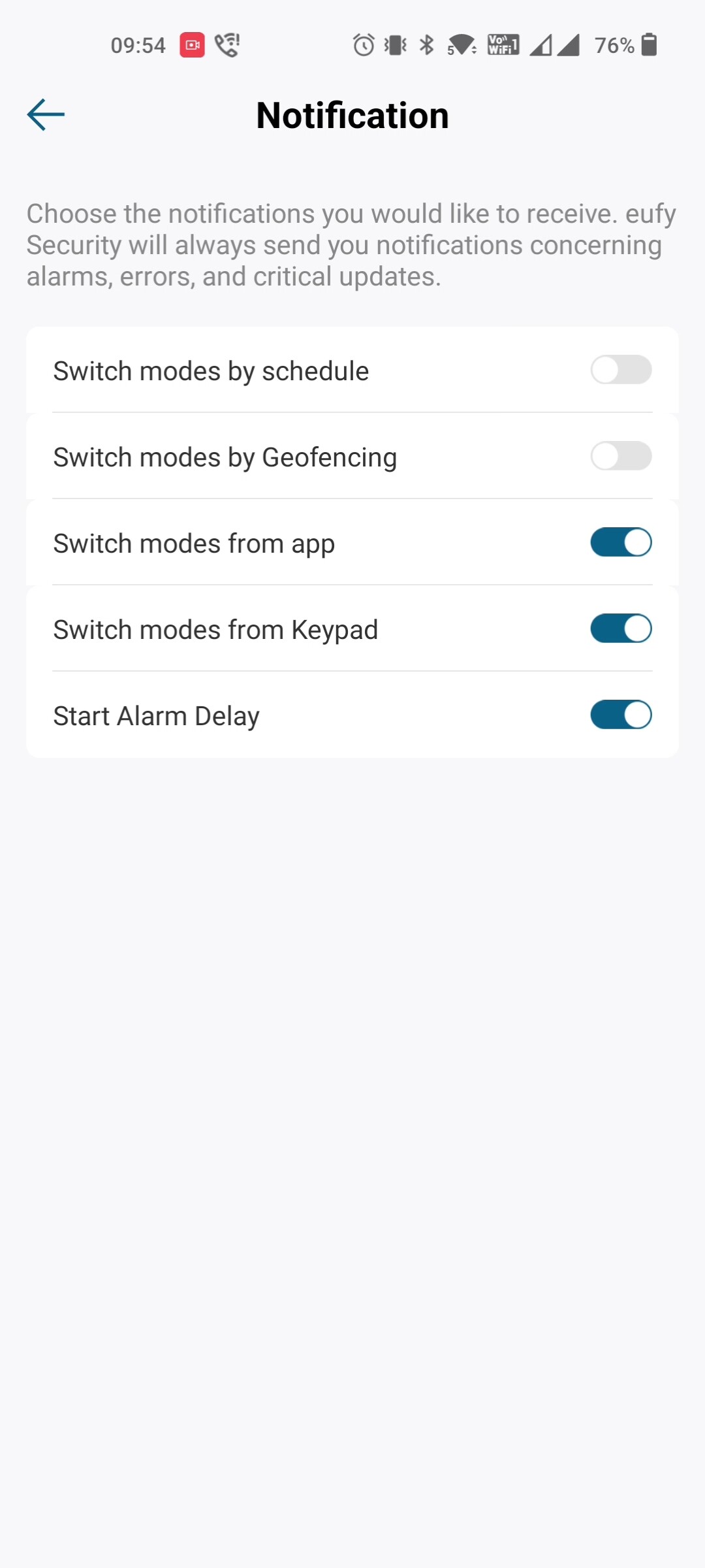

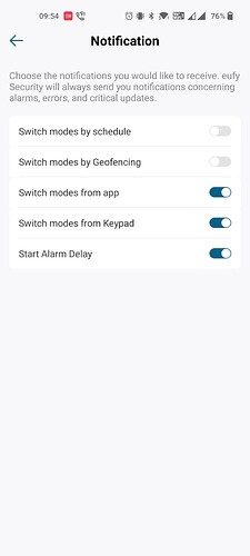

Hello!
Everything is running pretty well, but I have only one issue w/ eufy keypad. When I code and security mode is switched e.g. from home to away then it is not visible in homebase in homey. This change is visible only in the eufy app.
When I change security mode in homebase in the Homey than it is visible in the eufy app. Where can be the problem?
Thank you in advance!
@Jan_Vitasek make sure to set the notifications on your Homebase in the Eufy app:
