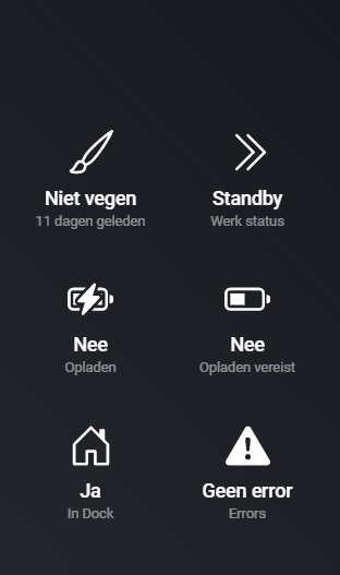

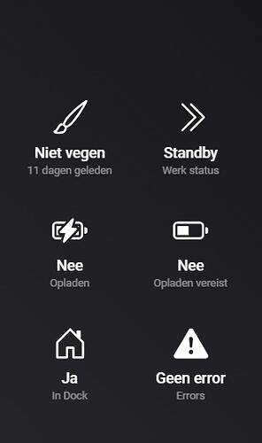

Hi all, since 11 days my Robovac 35c does not send status messages to Homey or receive commands from it, this happened from one day to the other.
I checked the settings in the emulated app and the homey app and thery’re the same, accept the the local and public IP address were wit worked with before.
Settings
In the emulated app and official Eufy app it works great but in Homey no response and old statuses.
When I click the Debug Logs checkbox, it returns this error message.
Error
Any idea of what’s wrong?
Hey @Hermann_Stengel
For the local IP. Did you make a static IP in your router?
The Robovac changes ip when it goes in standby.
Make sure the local IP is the same in your router and in the Homey app
Wait! Just restarted the app and now it seems to work!
So stupid I didn’t do this before!
Nice!
Tuya sometimes has a connection drop.
I’ll check if I can fix that
