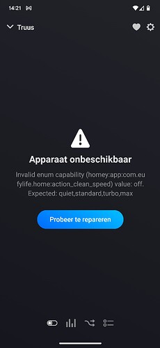

Setting the suction power crashed the device:
982972e7-e4bf-4a9f-a3e9-bbeb9933cbd9
@Robin_van_Kekem please send a report. I cant do anything with a image

Heya,
I’ve installed test version 2.0.6. it worked partionally when i set the suctionmode it crashed showing the following for my Eufy X8 pro SES.
Great work on this project btw… hope it’ll work soon in stable version! :slight_smile:
0aee69a3-f61a-413c-a8b9-852ec6d893d6
@MartyDog thanks!
Known issue, wil be fixed soon!

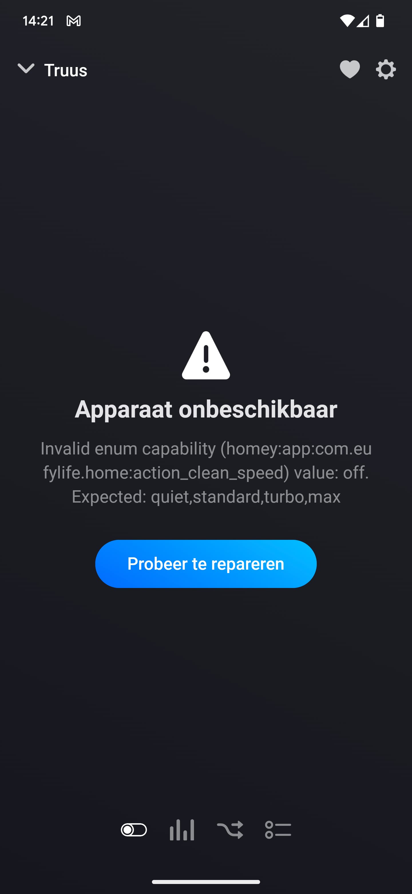

Same issue persists unfortunately: 88ac08eb-babb-40df-85aa-7ebe02e30416
i changed vacuum speed up and down (beep from robovac was heard twice) and then the device in homey crashed showing a triangle and this message (just like b4)
(i tried: readding the device, reinstalling the app and rebooting the robovac itself in the cycles just 2b sure)
