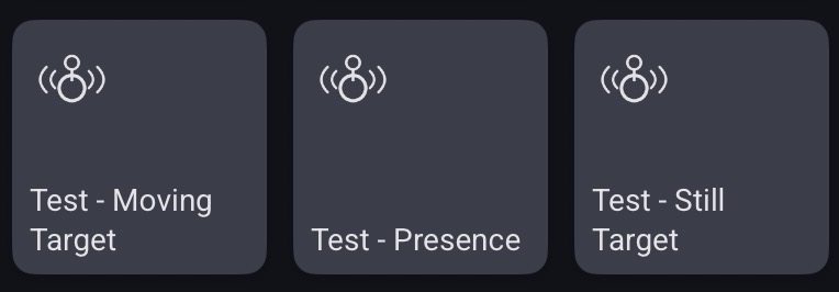

I have made a mmWave sensor and added it to Homey with this app.
But it created 3 separate devices. Is it possible to have these sensors in one device?

Are you managing all of these with a single ESP board? If you send me your YAML code, I’ll take a look and be happy to help.

This is all setup in a single ESP32 board with the LD2410 mmWave sensor.
Hereby the YAML as I use it in Homw Assistant:

It would be nice to have these values in a single device:

You’d try to add it with:
This is my LD2410 sensor installed with that driver:
That worked for me.
Thank you.
