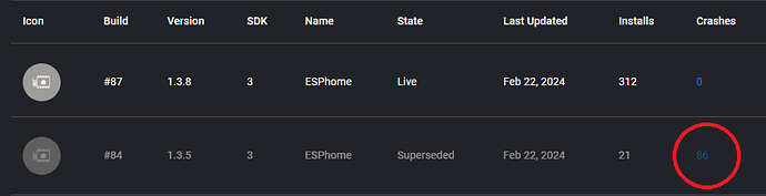

Yesterday I pushed live a new version that seems to solve:
It looks much more stable than ever …
Please report any issue
