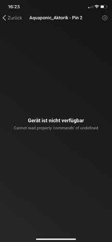

So, I can add the divice, but after adding it switches from “cannot read property commands of undefined” to the button switch.
Please try 1.7.1: ESP Easy App for Homey | Homey
It also has support for tailored pin-layouts. I needed it to support the extra pins in my ESP32 and was easy to add after adding MCP23017 support. I can add more templates if people use other type of boards.
