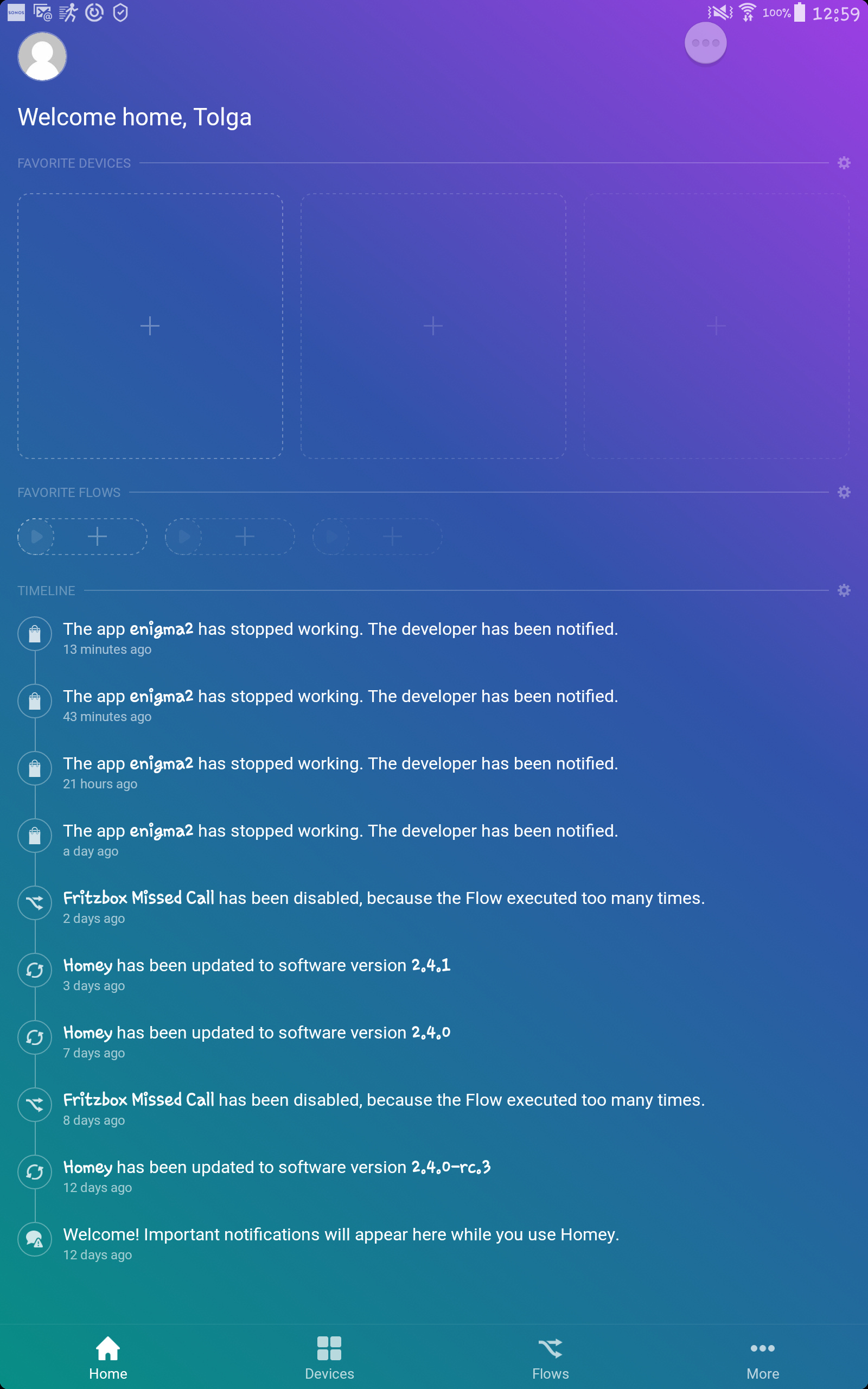

I updated homey to the latest software and the app crashed, bevor i updated the software it works like a charme, can you please look into this. Thanks
I did a check, for me it is still running with the latest firmware (i’m currently on 2.2.0 rc6 so its beta channel).
If you have send out the Crash Report with the comment, there is nothing unspecific. I only was able to see, thet the Box was not reachable and the command used killed the app. Will take a look into that behaviour, when i have time.
But can you please resafe the IP of your box and try it again? If it is still crashing, send out a Report and may i ask you to put your nickname into it so i’m sure, that it is from you!
Had a Crash Report send to me that complains about not saved Values, please check via leave and reload the Site. If there is still the address you add, everything is fine and it should work. There is no Confirmation or anything. If you hit save the Values are stored in Homey.

@carp3-noctem Hi,
Dont know, the app crashed since few days, is it possible when homey sends commands and enigma devices is off, the app crashed?
@Tolga can be that this happens. Need to investigate it.
I know that a crash can happen if no ip- address was configured by a user. If this happens when the box has no power, than that is clearly a coding issue. Will investigate it.
Thanks
I have found, why the app was crashing and corrected it.
Therefor i published a new Beta Version, please check if this still happens @Tolga. If not, i will push the app as stable.
