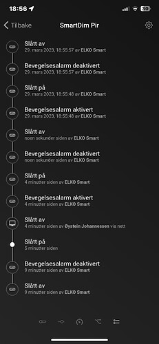

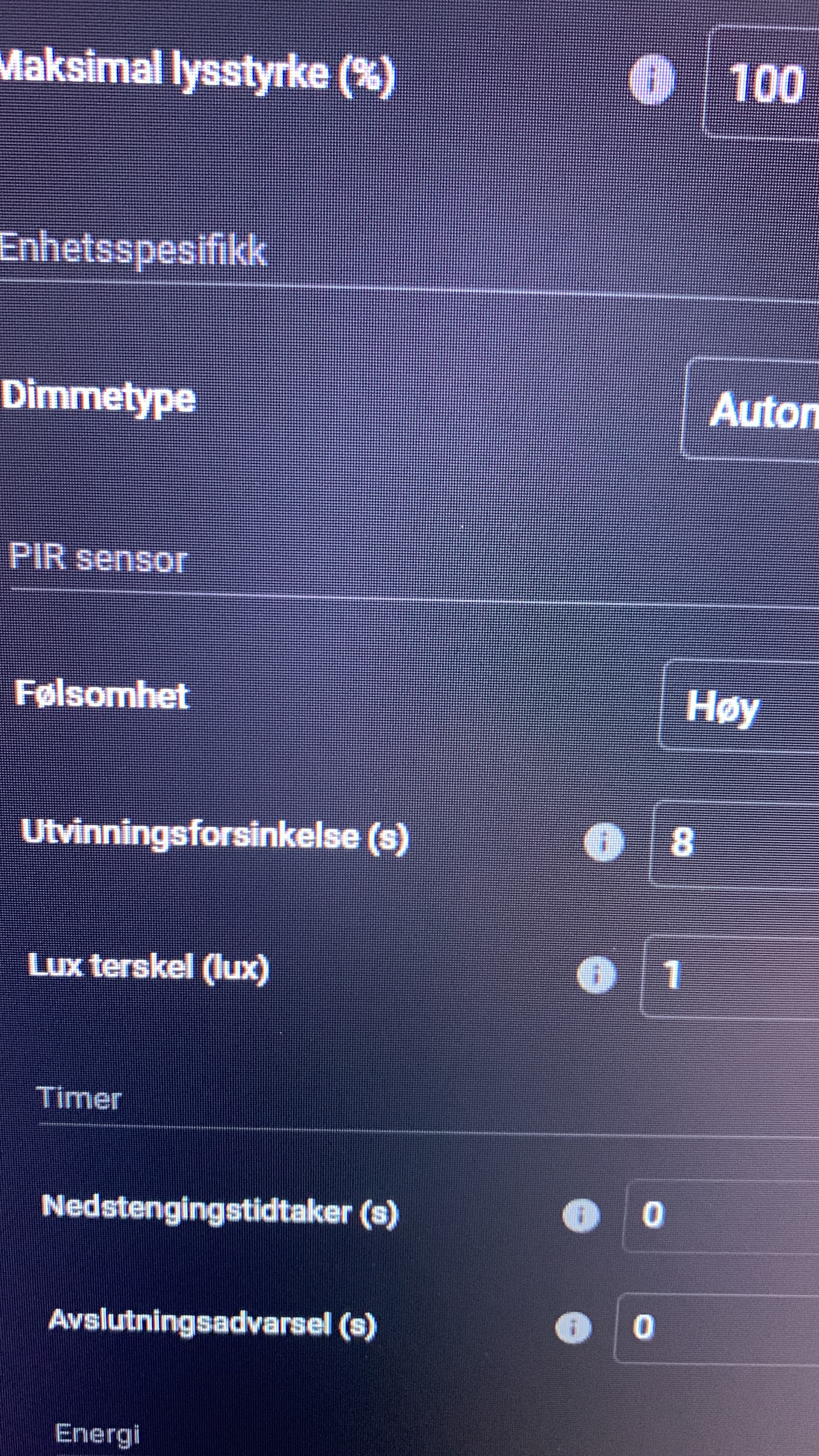

I’m having problems peogrammigng the smart Pir. How do i get the light to stay on for 15 mintes?
Why is the sensor acting like a stupid sensor?
When the sensor is deactivated, the light goes off.
If I set it to 0 sec, it is active all the time and the light does not go off. Can turn off the light in the app. But doesn’t turn on again when I move in front of the sensor. If I set the sensor to 60 sec, the light goes on and off when the sensor no longer detects movement. Cannot decide independently. sensor goes off after 10 sec and light after 40 sec does not go on

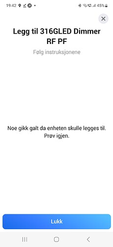

Elko 316 GLED Dimmer will not connect to Homey Pro 2023.
After receiving the long awaited Homey Pro 2023 and migrating all devices and flows from the old 2019 everything went smooth, except two Elko dimmers. Thermostats were easily repaired, but the dimmers only get this error message (In english; something went wrong. Try again). And I have tried numerous times, with the hub just beside and tried to remove the device from Homey and re-pair, but get the same message:
