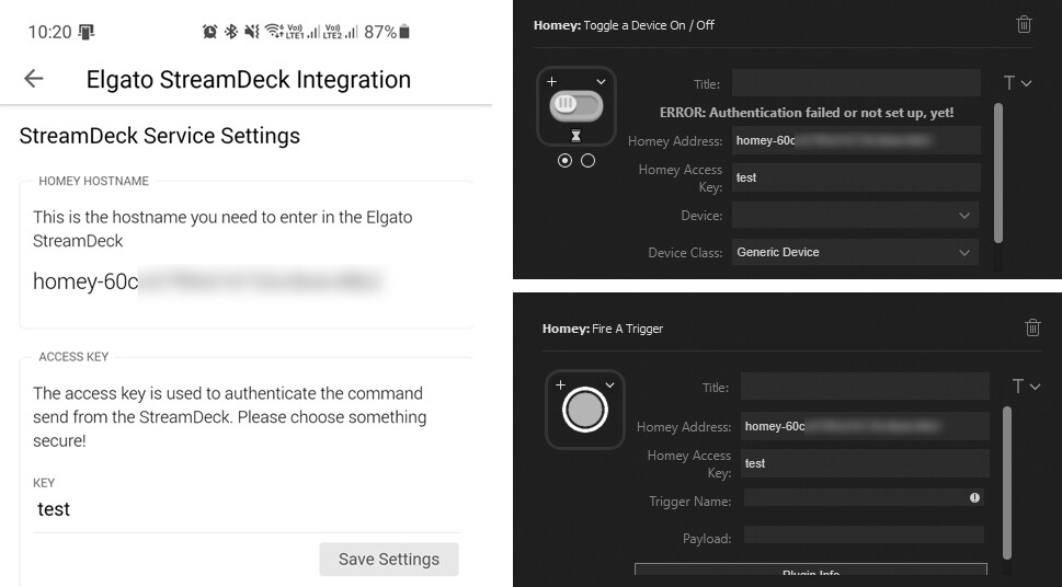

Thanks for helping. I tried to reboot router, but that didn’t help. Then I added an entry for Homey in the hosts file, and that worked. I’m not getting Error: cannot connect to homey any longer. But there is another problem. When I’m adding “toggle a device On/off” in Stream Deck I’m getting “Error: Authentication failed or not set up, yet!”. I’m using the same access key in both SD and Homey app. And I have tried to restart homey and SD.
That’s pretty weird. Does this only happen for On/Off toggles?
It happens with all, exception is “fire a trigger”. There is no error.
Okay. Thanks for the details. Please create a diagnostics report for me. Go menu more
 → Apps → StreamDeck Integration → gear icon → create diagnostics report and add a message including your forum name for reference. I will check the logs.
I suspect there is something fishy with one of the devices on your homey. Such can break the communication.
Here is report id: 8c03238d-0e7b-4085-9314-892dc306cdd2

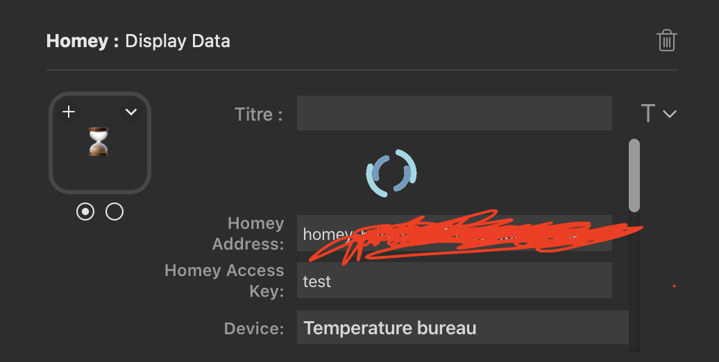

Hello, I
'm having trouble with the plugin again. I have an infinite load when I try to connect. However, I can access all my Devices, but it is impossible to select a “Data Source”.
I indicated a homey cloud address because the local never worked for me. It’s very weird (I’m on Mac Big Sur). If anyone has already encountered this problem I would like some help because the plugin is awesome!
Hi @DinoRayn,
I can somewhat reproduce this. For some reason the selectors do not behave correctly but I cannot quite put my finger onto it, yet.
What seems to work as a workaround is reselect your device. The selector for the data should be populated then.
I will look into deeper as soon as I can.
