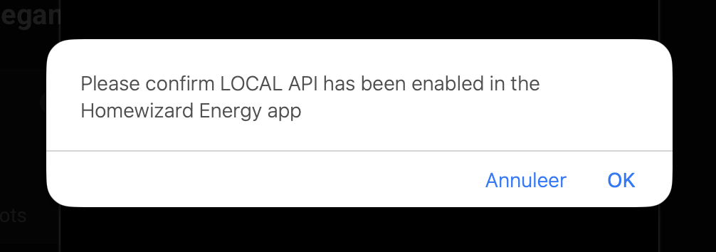

Yes, I tried the HomeWizard app but got this message:
I do not want to go through an API, I could do a similar thing with the Growatt app (great app but connects to the Growatt cloud).
My app reads the Modbus registers directly (not going outside my network) which is fast and save.

Homewizard kWh (yes eastron label). Use their own firmware on it (hence the API). So those will never work with modbus.
