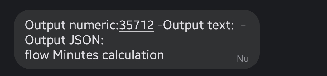

The expression
parseFloat(time('M',new Date(date("yyyy-M-d HH:mm")) - new Date(new Date().getFullYear(),new Date().getMonth(), 1)))
resulted in 35712:

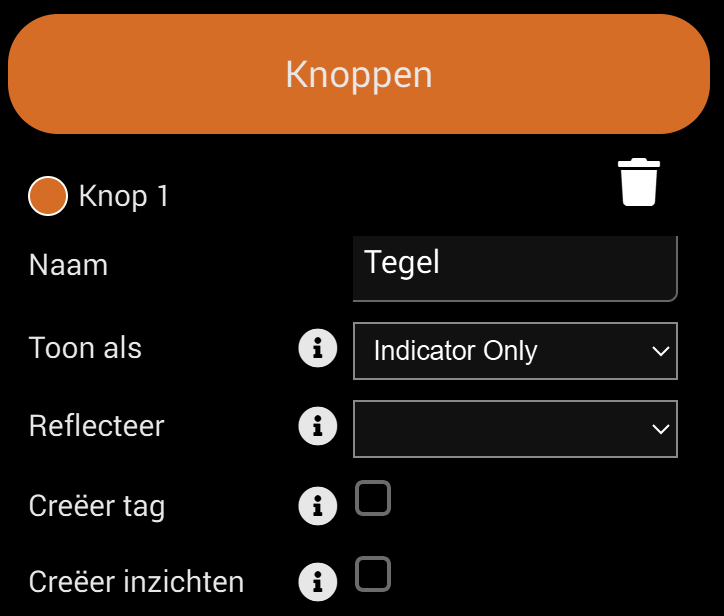

hello @Arie_J_Godschalk I’ve created a virtual device (button) which works fine. I was wondering if it’s possible to switch the device to ‘on’ in a flow without triggering the button.
The first button item in the config of the virtual device represents the tile. You can specify it either as a non-functional ‘indicator only’ or a functional on/off button. Next you can set it via a flow to on/off (without it triggering any subsequent flows).
Here an example of a non-functional tile that is set to On cq. Off using flowcards:

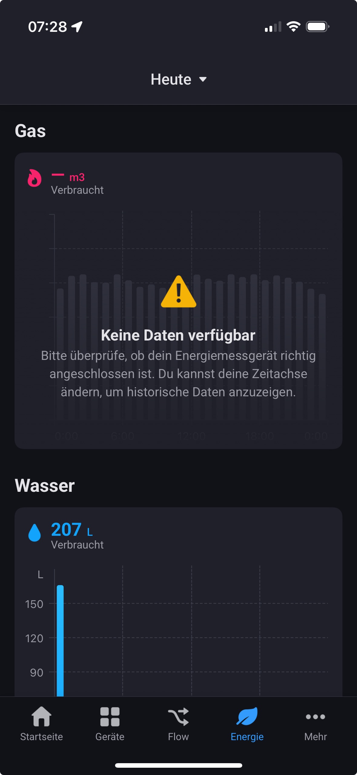

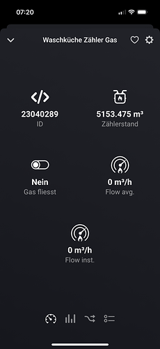

Ok, I gave the test version a try - especially because I would like to get the gas-/water-meter in the Energy tab. May be someone has done this already I can give me a hint. The water-meter works as it should in the energy tab, I do see the water usage in liter . But for the gas-meter I do get an empty Graph which says “No Data available” in the Energy tab even after 12 hours… I’ve seen that the meter changed after the comma but not before the comma since I’ve configured it (half day ago). May be that’s the issue? During summertime, only my boiler works with gas, so I don’t use that much gas per day.
EDIT: the meter-count just switched from 5153.xxx to 5154.xxx, but still no data in the energy tab. Something must be wrong…
Homey reboot solved the issue…

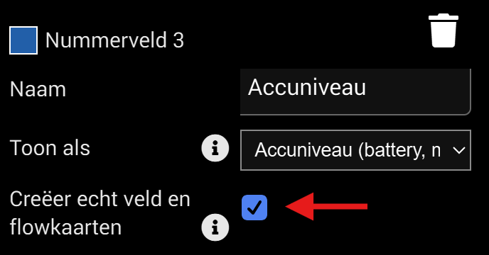

@Arie_J_Godschalk: I created an AVD for a temperature and humidity sensor. This AVD includes a numeric battery percentage capability (measure_battery), as well as a boolean battery alarm capability (alarm_battery).
This works fine and both show up on a separate battery tab in de device tile. However, this device and its battery level does not show up in Homey’s Battery section (with all battery powered devices and their battery level).
As far as I can see there are no specific options I can set in the AVD’s settings to make the device appear in Homey’s Battery section. But maybe I am overlooking something or perhaps AVDs are excluded from Homey’s Battery section altogether.
Can you shed some light on this matter?
So to answer my own question, I managed to get the battery percentage to appear on the battery tab, by enabling the ‘Create real field and flowcards’ checkbox.
However, I don’t understand what this checkbox actually does. By default it is not enabled.@Arie_J_Godschalk : can you please explain / elaborate on this setting?

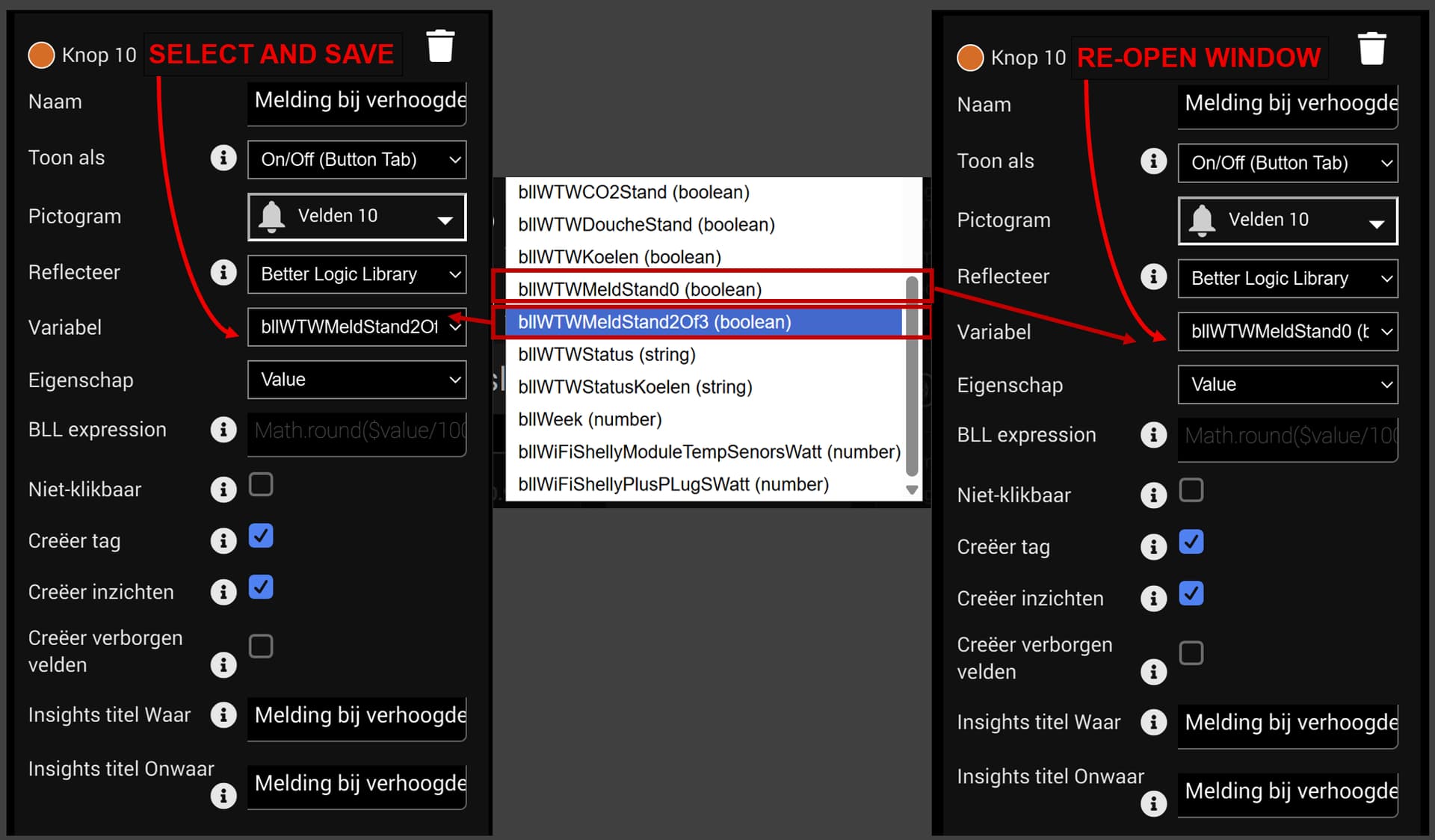

Hi @Arie_J_Godschalk, I am running into an issue in the settings/repair screen of some advanced virtual devices. I had this issue before (see my prior post) and installing your latest test version solved it. However it emerged again. Not sure as of when; maybe its related to one of the recent Homey updates.
For some AVD fields, when the value is a reflection of a BLL variable, the selected/displayed BLL variable changes to another BLL variable, though the actually used variable is the correct one.
In the example, I select the bllWTWMeldStand2Of3 to be reflected. After I save the screen and re-open it, it shows me a different variable: bllWTWMeldStand0, which is the variable one up in the pull down menu.
I am using the latest, currently available, versions: Device Capabilities v2.16.1 Experimental and BLL v3.4.15. My Homey Pro 2023 is on v12.7.0.
So the variable AVD is actually using for reflection is not what it displays after saving. Any idea how to solve this behavior?
