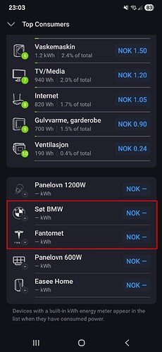

I was thinking it should show up among the top consumers regardless as long as it has the meter_power capability. But I updated the devices after you released the v2.16.0 version, and added the new energy settings then. Data didn’t register before with previous version either.
On picture below you see they are there in the list, but its not counting kWh despite the capability on the device itself is doing it.

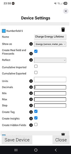

The meter_power capability is configured like this on both devices
I found that if I set the device class to sensor, it register data correctly on the energy tab.
Before I used device class other, and then changed to car when it became available in latest version. Non of those two would make the device register data on the energy tab.

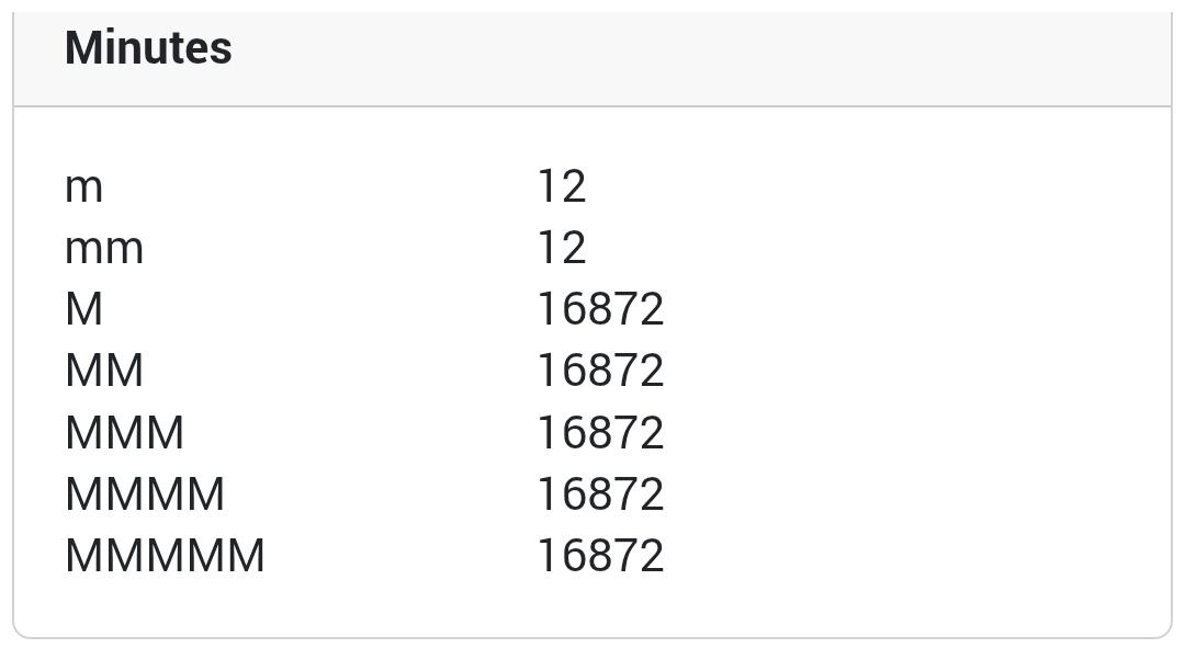

Hello guys, after update to the newest test version from June 6th, I have issue with flow functionality - retrieve the insights value from xxx for yyy from x minutes ago. The number is still 0.
Problem solved
I cannot read your flow cards entirely, but since you are trying to get a number in minutes: the first BLL card contains time('M',…). I believe this should be time('m',…). So with a lower case ‘m’. M = months, m = minutes.
