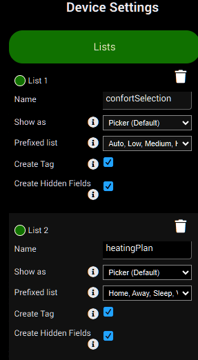

I have several AVDs, where I use also predefined “picker”-lists. e.g.
With HomeyScript I can read and write values wo issue, but this time wanted to use simple flow (so time-limits editable also by mob) to create automatic home/sleep change depending on time of day / other trickers (to avoid water heating at night, long story…).
(Am I blind :face_with_diagonal_mouth: or) I was supriced to see that “And”- or “Then”-card to read picker-value does not exist? (“When”-card not so useful, when want to tricker event only at say 10pm (only if status “Home”) and 7am (only if status “Sleep”.)
On “Then” cards closed was (but did not list picker-fields:
On some other cards I could see picker list as “enum”, but not in these :face_with_peeking_eye:
Made by working HomeyScript already, but would be nice to understand possibilities for the future (as not not mob-friendly editing)… any advice appreciated :slight_smile:

Thank you for clarification, checked again:
Have a look - I can see all other variables with browser (except AVD ones)
AVD (repair-view): Tags selected
As number-card (I also have those in AVD):
As text/number card:
but e.g. PbH-variable seen normally:
Same happens when I take Crome (blowser not using before):
Why are you searching for hiiden_ui?
And perhaps, uncheck Create Hidden fields?
(There is not really a reason you should use that, unless you keep changing the Prefixed list you use.)
