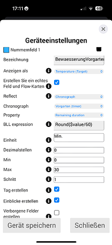

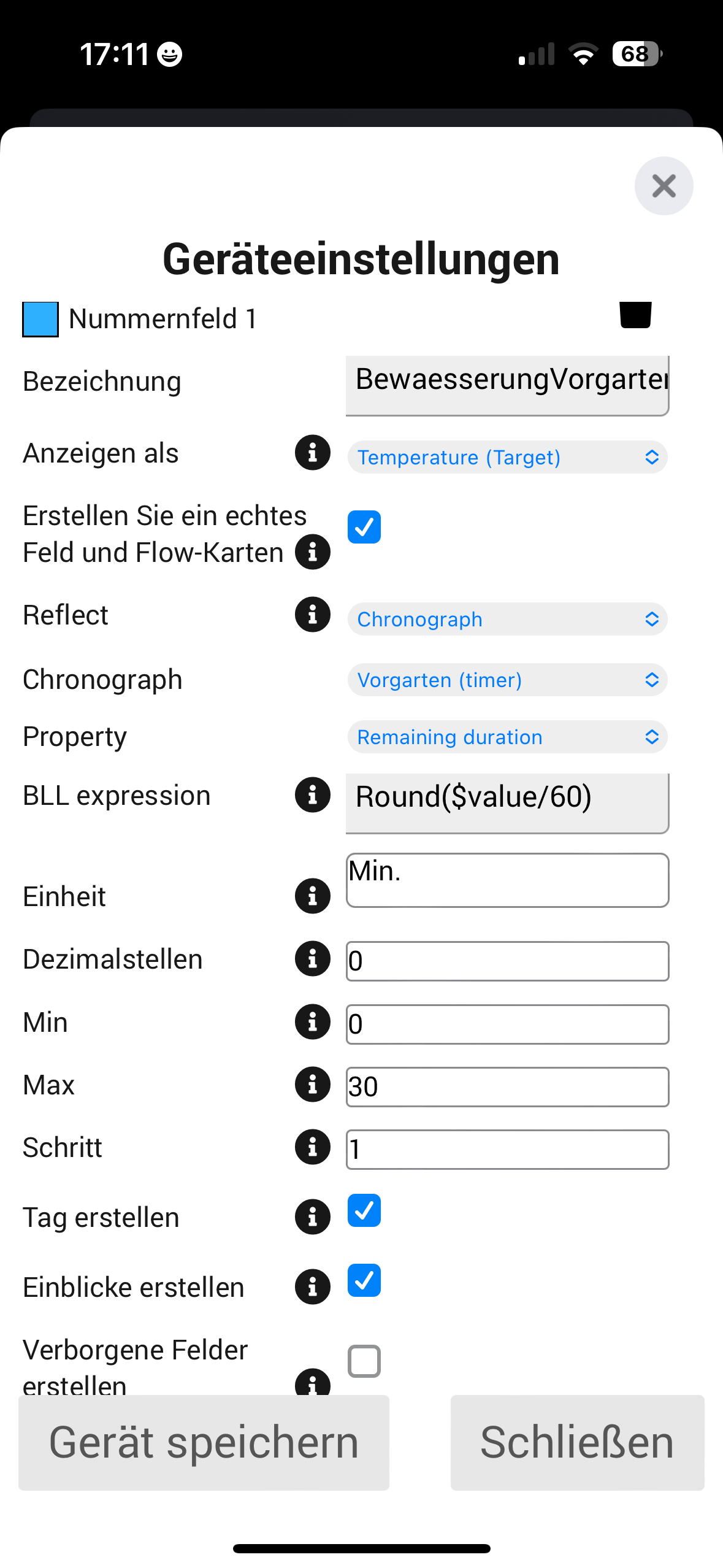

I am trying to create a „dial knob“ to
  1. show the remaining watering time
  2. to change/adjust the remaining watering time.
My first step was to setup the „dial knob“, which is close but not quite there:
Is that customizable?
Regards
Range 0-30 minutes is fine.
But there shouldn’t be decimals, and the unit should be minutes instead of degrees…

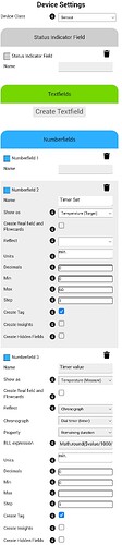

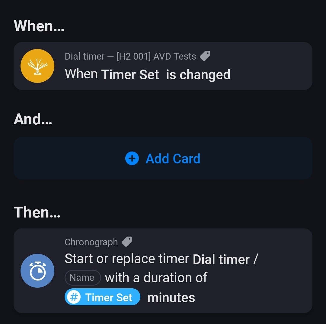

Hi Naehle,
I’ve a working example here.
The ‘dial’ (target temperature) sets and shows the timer duration, and the ‘temperature’ indicator shows the remaining duration.
The decimal seems to be a Homey thermostat device type default, as you (and I) found out setting 0 decimals doesn’t make a difference.
The temperature can be shown without decimals.
The ° as unit, also comes as default, and can’t be changed to f.i. “min”.
But, when you use, like, “Sensor” as the AVD device class, it shows the entered unit “min” as status indicator, compared to device class “Thermostat”.
Settings:
(Because the running timer value is in ms, the BLL Expression should be Math.round($value/1000/60)
Flow:
