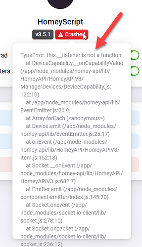

Creating a completely new HomeyScript (see Tutorial: Migrating deprecated scripts - HomeyScript), you will get this error:
TypeError: updateDcApp1.apiPost is not a function
And trying to runFlowCardAction() instead often causes the HomeyScript App to crasch:
await Homey.flow.runFlowCardAction({
  args: {
    field: {
      name: 'Elförbrukning Pelle (kWh)',
    number: 4,
    mode: 'nothing'
@Peter_Kalrsson,
(cc Arie)
1st of all, you are now using a brand new Homeyscript test version, Peter.
Just install the live HS app version if you want things “back to normal”.
Not sure if you should inform Arie already about this issue at this point.
You probably should be able to pinpoint the issue by reading the tut from Jeroen (Athom) and contact him about your findings and/or for support here, thx:
1st of all, no Peter, I am NOT using a test version. This version is live - for all. Thanks.
I have read the tutorials for sure, so let’s put some fact on the table here:
  1. Your existing HomeyScripts will use the old version of the API.
  2. When you create a brand new HomeyScript, the new homey-api will be used.
“apiPost” will no longer work, and there is no work-around mentioned in the migration info.
To the rest of you - I finally found a solution using runFlowCardAction(). The problem was that I tried to read and update the same Device Capabilities fields in the same script. This crashed the HomeyScript app. Solution? I put all the read and write calls in separate async functions - then it worked.
