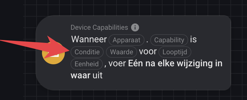

Is it possible to add a “between” option?
I’ve got a device that’s switching constantly
I can’t use “equal or less than” since that includes 0 ( zero ) that i use for another state. (also for greater than 0.04 )
If i use 2 “equals to” they both trigger
Or is there another trick somewhere that i can use?
Are you talking about calculations or a flowcard?
I’m sorry i wasn’t clear.
I mean on this

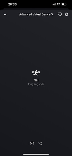

Have created a device with a motion alarm. However this device is not included in zone activity… Why? Possible to fix?
Make sure the class is Sensor in the device’s “repair” settings and not the default Other, and that also the “Create Real field and Flowcards” setting is enabled.
