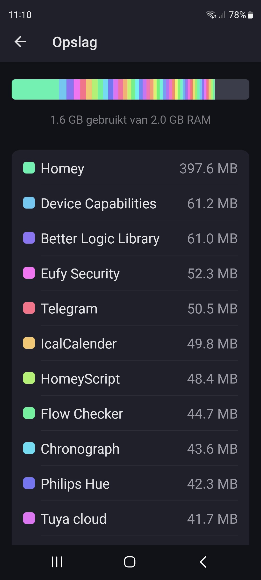

Hi @Arie_J_Godschalk, in terms of memory it looks good and the consumption is a lot lower than before and the app continues to work with all my restored AVDs.
That’s going well.

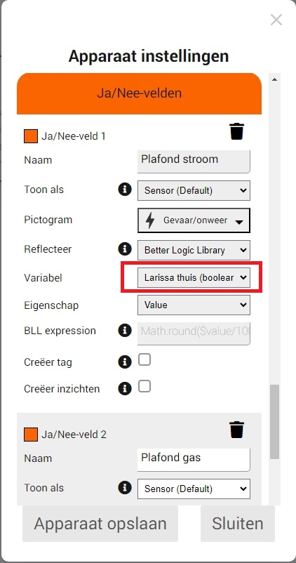

I do see something strange now and that is that wrong logic is displayed in the AVDs after saving changes.
After restoring my previously deleted AVDs via TEF, when I do maintenance I see that there are incorrect logics for the various items. At first I thought it was due to the TEF, but if I replace the incorrect logic with the correct logic and save it, you will see that the incorrect logic immediately returns.
I think the wrong logic is being used for the right values, but I’m not entirely sure.
This is with multiple AVD’s and multiple items within the AVD

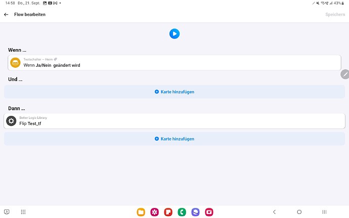

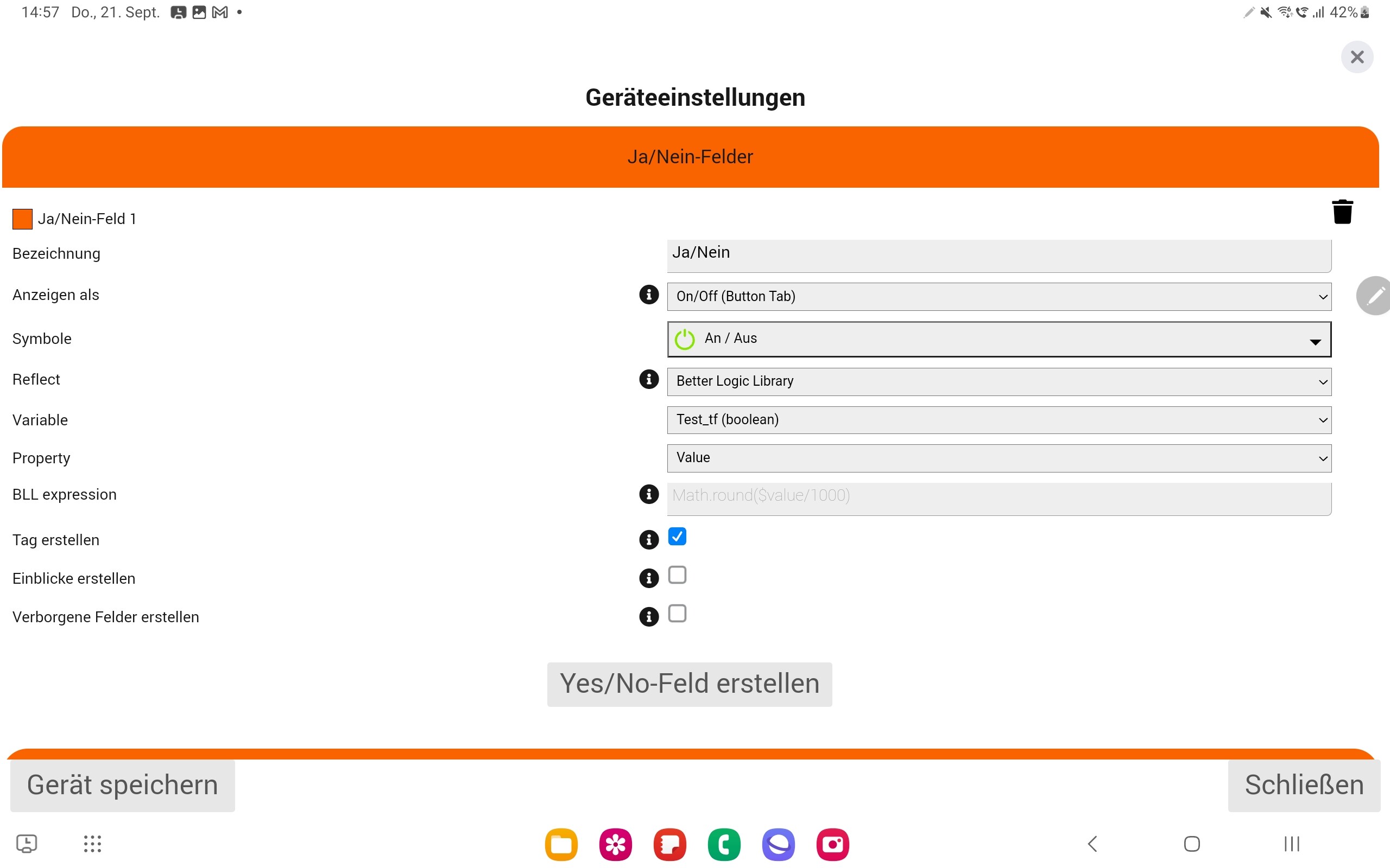

I try to make a device that is showing the state of a bll variable and switch that
If anothrer flow change the variable it should show that.
You can use reflect for that.
Just select the bll variable.
Thanks for the quick answer.
That was what I tryed.
But only creating the device and press the button did not change the variable.
So I made a flow to switch the variable if the button is pressed.
But now if the variable is changed I have a nice loop.
As in: it is working like you want?
Or do you have loop that keeps coninueing (a bug).
And indeed, BLL variables are currently only used for relfect and not react, the will update the device but do not respond to pressing the button.
I might add this in the future.
