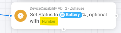

Just one problem regarding to the following topic:
When I clear the number field also the first text value (here Battery) is not shown anymore.
If I input a value into the number field after that again, both values text+number are shown again.
