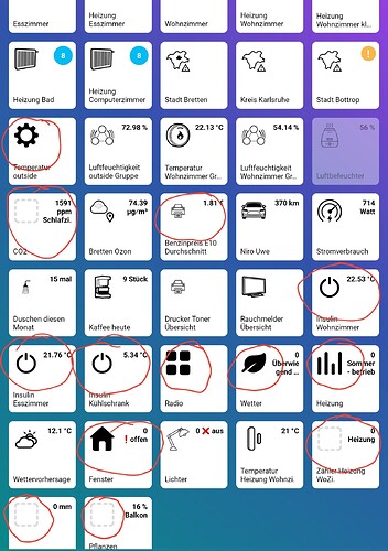

Since the latest update, all my icons are gone. Error ?
Reboot the DC App?
Send me a printscreen off your app settings: Devices and custom icons.
If you press the magnifying glass at a custom icon, do you get a list of items?
Wait, i see another bug in dev. that might be yours (only a few have that version yet) and it might be why some things don’t load correct.
Update to the newest Test and check again?
I dont delete icons at all! there is no script in it or anything.
A few TFE and AVD import bugs (with variables) have been resolved in the current TEST.

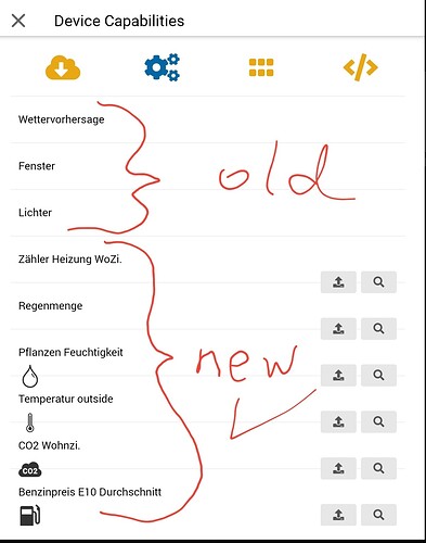

The symbols are displayed incorrectly or not at all
Many devices no longer have the option to re-upload the icons.
Screenshot_20220930-171614_Homey
My previously uploaded symbols have all been deleted and replaced with standard symbols.

I will recreate some affected devices tomorrow and fix the flows. I’m curious to see if the symbols are uploaded then.
Edit:
I have just checked again whether it is an error on the Android tablet.
Unfortunately no, the mobile app shows exactly the same behaviour. Many devices don’t have an option to re-upload the icon.
I’ll check further tomorrow, unfortunately I have an appointment now.

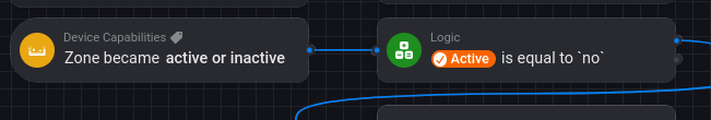

Hey Arie,
Playing with the Zone became (in)active trigger.
When I selected “active” it works, but not when I selected “inactive”.
However, it does work when I select “active or inactive” with a condition “active = no”
Screenshot from 2022-10-01 01-54-14
Hi Arie,
since this problem only affects me, I don’t want to open a big can of worms.
I have just deleted a few of the devices and then created new ones. The newly created devices now also have the option of changing the icon again.
To save you a lot of searching, we’ll make the following deal. I’ll recreate the devices and see if I get this problem again. If so, we will seriously start looking for the problem.
