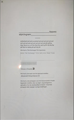

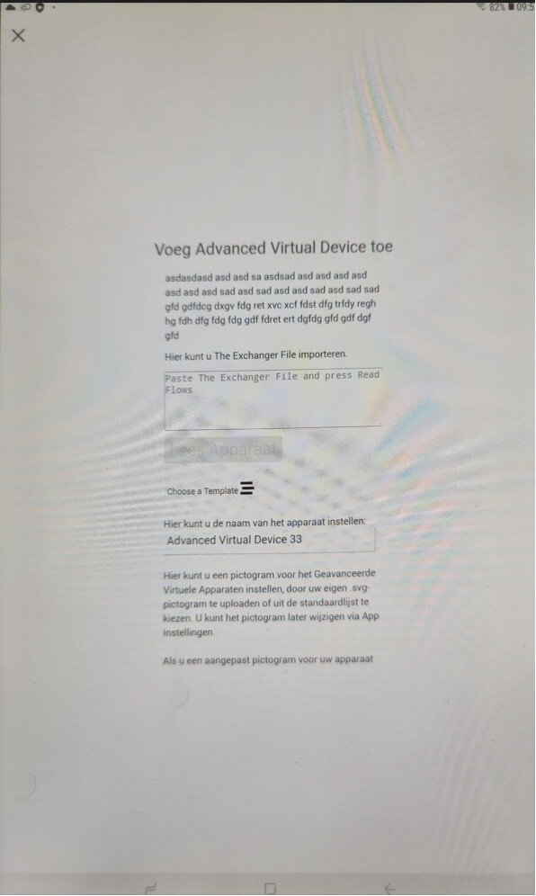

Grrrrrr, i finally found out whhy Device Settings/Repair, for every App i created, has a very very very small view in tablets: As soons as i call
Homey.setTitle() appareantly, the view gets a large as the title is…
This off course is a bug i suppose, and will report it to Athom.
Glad i finally figured it out, i allready spend a lott of time trying to resolve it (for hoop and others).
Just created a support ticket:
Here the images, so everyone understands why this goes wrong.
Afbeelding 1
Homey.setTitle(‘Apparaat pictogram’);
Afbeelding 2
Homey.setTitle(‘______________________________ Apparaat pictogram ______________________________’);
Afbeelding 3
No Homey.setTitle.
Resolved in develop.

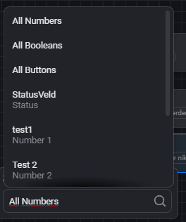

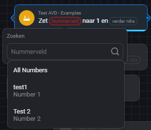

Hey Kai,
I have added an All fields* to every Set card.
So set Expression shows the All *** for all types it has configured:
And every other card has one added for its type:
Its in live, so are all other resolved bugs and improvements from today!

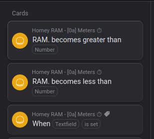

Arie, I have a feature I don’t get yet:
When I use this ‘Then’ card
I can choose to select this. What does “Execute flowcards (When)” mean?
Very irritating, someone still using Homey Mobile App :stuck_out_tongue:
Answer: It means that after you set the value, it will execute flowcards (When) for changes.
So if you have a flow with an actioncard If *** is Changed/Set, it will trigger it.

So, okay, when I don’t alter the default “nothing else”,
the WHEN flowcard
“if [capability] is set/changed”
will never trigger?
Okay, odd choice to make “nothing else” the default value.
… while “nothing else” is default, I never did set it to “Execute flowcards (when)” with every card.
Well, now I need a card which sets all my “set [capability] to text number” action cards “nothing else” option to “Execute flowcards…” :sweat_smile::crazy_face:
