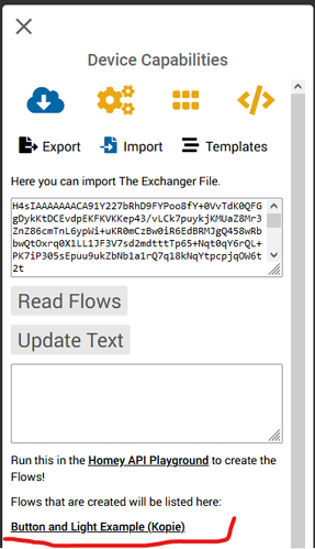

FYI Adjusting the Chronograph timer name works fine using the TEF import via App Settings,
but not yet thru the Device repair way and then pasting the TEF and clicking the Read Flows button.
The timer name is read correctly as you can see in the code in the screenshot, but it doesn’t appear in the edit form above it.
Screenshot
Just to compare, screenshot from App Settings:

Try it with the new test?
Check, works fine now!
