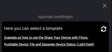

What I missing in the template is that I couldn’t choose a switch, only lamps in both check boxes, no virtual machine either. Is it my homey or is that in the template?
Do you have any OnOff switches?
I have some, but not a lot. Because a lott of real-buttons have different/there own flowcards, not directly compatible (yet).
You need AVDs with Buttons with OnOff with Create FlowCards on. (only one OnOff-With flowcards per AVD can create the original Flowcards).

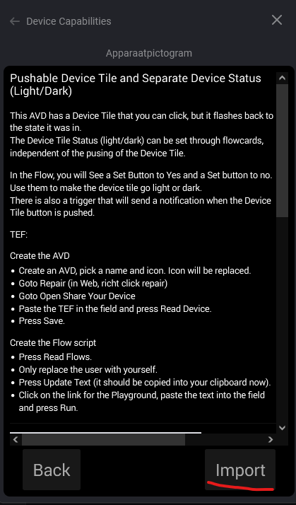

It was just simple Template, to start of the Templates coding.
When The Flow Exchanger is done (and that will take some time) i will make beter Templates.

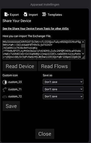

Here is the TEF for the Light AVD: (Without the flows), created this one first.
H4sIAAAAAAACA61WWa+iWBf9KxVfLcJwDtNN+gFBVFRQQNDb6VQYDoPMs1ip/97o7a9u1dfVye2keYC4h3XWXnuz8evMR33soY1X5LOX2Ro2G+HtEgVoWabNudrxzm/hnjZYZWO8GqdbnA1dYB7PueqXqrpYqzopXNu6xAE5HyN1lSEALlaUxZsyuFLbPr/j+Ipg11rAw4CO2hurzM8yDIBFaypUeRK3IRe4LH6Ym7dqPfAHwLoDonnQ0nOyOfC8dp7jlATwtk/vDd0eQs5Y9+dTFM2RBSCbmpp0RXfGw9cle4bjfH8bZOW8GJA7oiVS74cIpHiutINPxoeMQfkN9haTH5nOUgcJ71j53PcWEd32bgpBy/Z9z26TVdVWzMWvRxi4NEcJVM0oqnW7XtzNzYtN+dXfNV6WrmIiTe+5wwqle42hfiSo+Tn0KfV1rZjF5iLV0auE1svBFOjRS4ebnVyUqu0aJuks7qAt7srprG+txYJTB5LfnoDo7XHdipNMO0G9voYyFxYmcSkpjiPh3tmn26XXsGOlc6/ywtNG5ZqJ2y5iFoOg25dk2fRgIIwqzLWb7JkE4qswbk6tEjup7Xb48hLqVCErEYx31CiJzJLYsDu/2uVmKFFeVItzzVpq4NbreHlW7JEUEtxB7J6PtYQ/6jckt6ekaet436ryfHdz09MQbjYGIfPCsbS2tk2sy+1ILFmTR3RXVruLe9QDr4InRokhsadcRprvz+NWDKx8CURZLZ2FoVXHxnVIEUjjxqC5Anr32MzOPpGb2fXQmoF28MRkcZGWi6vdLfDFrsxxJuF4zYjwTAVwzy9pKieIRlnz+JLBV3ykXuQiWwp9uT0wK6bgkmm8VjoTOlfpQuIRg+7RmV2QfHIg6sid9/Ne4uRm7cirSr1Td8leNvpxcXACcVMdjllTbU7heY3mKYRlupLUu9bumM1875z4+gIszjpBylyu9A7tttohCY7HfmP0luhfXkUflZpYL1LtPrCVwd87VukPq50mbwbf3hhRPAfiOrxmByRsvZHZCEdwsgohp+ojTXe6mWwY4iopRKDHiZy0SzLSQinjoRzabSsr9E1Ymfb6ICuAEuLuWhJESFfIVyXU2kcxvXr6yhgv8114oADDsJA9QrOaawlIlNrVSqXilZxX1Rjsmv0qkZwM3sPKVkIKlycRKdgtc1XsT8WG9/WdP1xC0jb88zHJtika16EclYFvyGFHGiMtE7ZAFGg1rFy5DYdX9WrbQvKqjSNbVRWl7YSogowUD6l7vHp1UpBySvTWtUsRacvJzSDH85EeVkK84/XC1QN/dxPYxb0120wgsr2SgBMuX88y6TMlbpD+vO49oTsN3rS6fvtt9nnmdU1bZI+91sxevn77PCvqOIxzJ93406JjOY8EyKMwmqUdDCKEMB74FEYil6emXUQGLD+BNKht4zx8IMxQjupw/NI7aYe+PGBbJ29nL3mXpp9neZe5qNYCE91aOUapP6UQ72b1+fyFY1EUKXLyX3m6ti2+O8h3h+hkqHZ+yPDS6Tkr2gjVE2X3mUeqU9Rk1XItCN6tYo2cFslpMYhO/Uhv6w69eyPkJWiSJ3DS5t1soNKppzTRKR03TuM2Rs3/x7wBm074t+SoGIQnv7z4kYkUN46bfj9s6o//EJkE0wZAAcQQx5IY9DwW40mGx3gW0jRFIwpy1CPu8bEyhrj1okerv5c/wXyos38h7OIwan8GmBCc2cvvX2fxZKNI0vNJDmAUpCYsxiUw3mU4jCQJiiNd5FIsmtLfyXxycv/TE/XT8uZkZfpwo//J7D3OBT7BcuxUF3BcD4O0AzCO5ynMcwLgezTtOR58xN2evR2f92I6ICoyNL68fa1fPiTT52cNT92/PAhMhmleZ9PeDsPnqExt+X3mED7H0wGDuT4IJijWwTiahpjnOyz0AeB5kp398ZDlI4FvxCHxz9Q/+Oa9Uf+LsuO18fRjIgEcH3Ak7WFswLAYnP5QYDyCaMr2CcgwU78I5if1SOI/0e85pL8WkKUJABBBYAHlcxh0EDcNCelN9U3FcAQJeeA8BfxQ4M8C/pr9v5Hw+c79qOG3b398+xMJhm899gkAAA==
Here is the Share Your Device TEF for the Switch (with Flows):
H4sIAAAAAAACA61UW2+jOBj9KyNeOwiMzcWV5iEhTUJCkra5kYxGI2PMrVwSAiQw6n9fk27bGW1X6krLA4jvcnx8vmP/EjxWR5RZNM+EW2GMTlbv5TF7DVg2iu4+9FpjuLawbcDxfXDvhlJxzMZFWzgDOrF6yz5KClWa6UmvnCArqkfOBErOBh+qutB8t5VsZR9aj82lrR8xrg2p2O6dSHNi5G+0jOgGhap0nxqzcLjPtwUpYnzjAD0nqxneHt2ZRGLTiUuNLFgV71v7OF0OypV/tGfzdJg5yiyJ79AiV7wibchybLu2PKpX6615cZ5o+Hh0zUXo0Wq4Hp0n7mgomU52d+57auME8oQ522VTUDAdHeJ9TgYXoGvD6hinAyWxk1Se+I/rG0rvIthDq+F4liQh2W4Wdv8p19tLXoxtLs3e0OBg1wvZJFzXxXwQ3OO+dU6dKbbazfbo9XZ2FTSntqT5YRoAaEfWUlb3cDtbu499ZJtag/b46QFWLQ28Q04O2/k+ipvEtL1DUG8Puby6hKMqnbLdcXNWT45ehhZqVByi9Sa2pjPnFG1aho95Ot5Zkm2GaIfuexhMtsnQ3e2ePGzEcbqaDWyHHX1rFzO7Z47SY//YDnBz96Dv8K4wEcwzezFjd7tgU9YmcfY4S/YbpHoRGsXR2dEkZZ2PFto48jWjrefpTTWaXm40SfPva39+mB1u6oPkt/J8qiiaHjkKlNLhE1Llc2erb9+ErwKtTmWedn47Cbe/nr8KeREFUUYSy+MGBNAlgPlIZIYORESpLmKgYRHrSFUVlSnIUDjIiZVllAUdgsAyVgTNz5okFfvZwZYkK4XbrEqSr0JWpS4rFv6KXcphxBKPt8jv4fn1+0Gin+cJI9lHmaos87cEeE+YJGUF+a2DJvwr5GXICk7ZvfaBOa/i0UW28P33qFkwUrJhkp9NUnTtZVGx92zI6BPj8vgkOb2Hl+xACt5mkgNxoyQqI3b6R02Yn3tXGln++4KD6ETc5A2Tj8HrtPyU/LyuuyuW56ikYTfRt11yGH6cAWRUEVVdJSJijIkYeooImIsV39WBr+NXBDsKwvJPAI5AhNvvv4SIxxQAqAcMKCpI4ViaK4vY1QwRAFkxgMtcRWe8/Z3MF5J5X66oX+4uJD0kXZq9qkm7daEn64bO9wWJS0WkEigaGCsiJT70qKpSQlFXd7mOsLm+c75AmKesuX25LG8/6dLoVfefHQEe4LYUSm734OoIPpbvApE9A6u+Jroe9DmUTkRDVZFIPaIjD0KMgS786GT5TOELcST/O/VPzeeV+t+UCS0j/sNJQOJBA6hU1H1NFxFGvogZYrzbk5Gm8XnJ2h/qAfl/0e9q0o8F1FUZQibLoq94hogIM7hJAOX745sxZIAwJFcBP1X4p4Afs/8vEl7P3O8aPj//eP4LOqGY+3UHAAA=

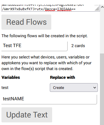

Now in Test: Create new Variables when importing Flows:
Next fase in test now:

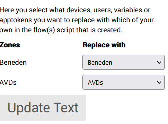

@Peter_Kawa in Test now: Zones supported!
