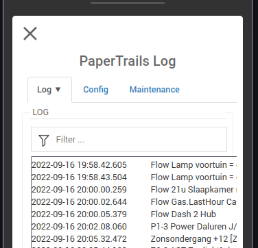

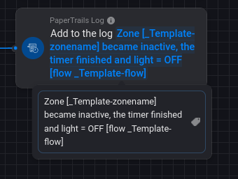

Cards are on the printscreen. Its like a timeline notification, a textfield. Text gets added as one line, to a local logfile
source https://github.com/Dijker/nu.dijker.PaperTrails

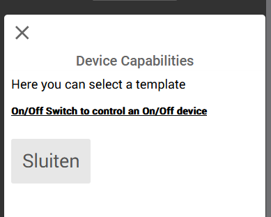

@HuisCHovens

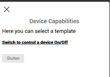

In Test now!
Ready: Templates directly in App Settings straight from the Forum Topic!
( i need to work on the design, i know :wink: )
App Settings:
(This is the text from the topic)
Looks good. can’t wait to use it.
My homey is naughty :wink:
and unresponsive.
already rebooted no result.

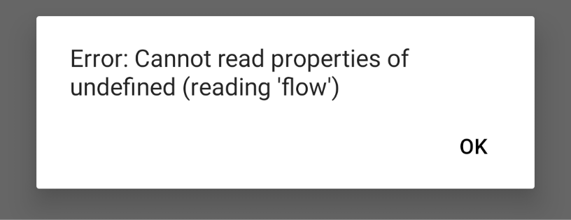

And this error
This just means that the flows are not loaded yet.
Wait till the app is fully started and then open settings.
I just get that message no matter how long I wait.
You have advanced flows i assume?
Send me a diagnostic?
It’s in the app settings (or close by).
Yes i have

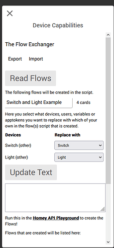

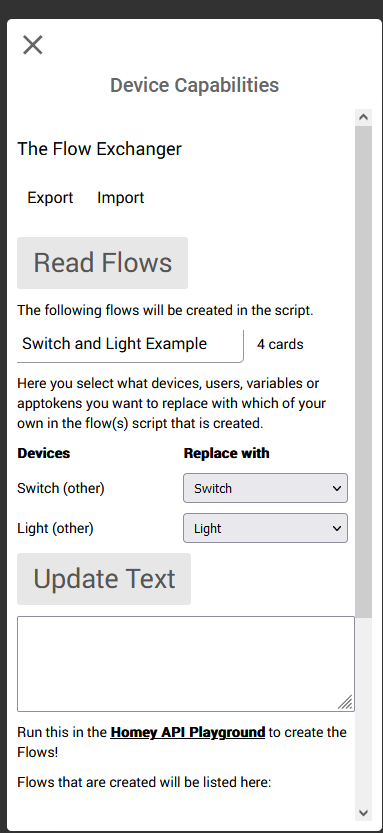

Okay, here we go:
TEF:
H4sIAAAAAAACA9VUW3OiTBD9KxavCSvDdfCN1eAlaoiajearrdTA9OgYBITBWyr/fQfMJpvdfUjVPn08gHZPT58+fbqfFQo7HkE/ShOlpfTMou+dn7Zn3E9P90575J16czy/PiVXs4PRm/H5cEEW7OCJ/S31bjLmLRcW6yWim+adLFgfdkZYzC/GZb50Wfn1QIbbADsjvbM67LXNfAn3h0C4eeE02RCQr80XlO6DAGXHTjK/7ian3uCg05NRXO/GfMXxYry9mw46dPmNzQbHoDPshg/69Fiu92YfoptUc2fO2t/6Xh7cb9A3MfRZcOHeNmNsEM23kbtIORTRYkK3/Wzm9eOnrt4dDHrWdgn7duBfJajf5fPAz/W77uCweBhfb7N+dgesqQ3ucp5PyXQRx6ObCRuOr2Ykw9l26w3s/nZ38tIHb5N4JZv4qy2frkP/yiTrrJtMuL/K2rdJLxwneGWvrOvlwFmciok+cRaT4kG/dUZU/ttZveCu1/E8be2OlqOABXkyTbRTcGyHNx1HGxIEtwLWi4c5NJHYuKm2vnjQjBKNim+np50+t75ezJsl8jNv6XnKpRKVhUg3VT8LpfX8cqmkOV/yhMR9KhvMGDFAs6kKOjZVMwKqupZLVYaxo4OrIUaIvKQAIXiyrG5QIIF8eXzckbiEx+paQRKhtJIyji+VpNyEkN+wGRyEzyGmMkR7N4/r718cX9M0BpL8zVMKkb450LujTTaQk18iolh+lVSsIJeQwzoOjeUpaT3f8m5u50AE+HG6b5O8imckLuDdvYLoCejv5ilkJJdxbZKRkMdcSCH9cWaV7r0KSFYWq7PtkSeUR0Skv+Dq8IKE8VsK2Rdakfupfshz1XAGbwkaJKGN4hVcY8ZjaEwFEWVR9f+NkxeZpKyCI4yQjhmowBhWTdt1VGxhrDJk2UAQAcdwfibxcg6NwZdGN6VFtCLxU32NxPDfs8Kl3wzD0LUhUommWarJdF0l1NBU4roUqANa6EYSxefxym6JvIQa+LNi6JpmEsNQCaFMNRFFKgGLqsiJMGW2aZqo5uNQK+BYv1OZa5Vu4Ng677LWJ0VelSPkcCwhf9zxXJQkPl/wGP5Uj3g/Uk2FZEHBhk5pZDqqGZqSTE3TVNfQsepGjisdmoZtU/leUybbW6m1+sGr4XuVQkXPbyqlckHlPBO83sJncwNJ6iX3n0p4psTU/0LKhiRE4m9tUilheK27EuujkEP7WiSJ6tyvsMtC1lsJ4gzzT01cngv6lLDk2Y0EUOERIitazSbJ+BciJLovUbppVsmkbUcEqUiuHfWuUmTxNcSWcp2kWUMuJKB5+SRqSYaOQW3qGqqD7UjSoluq6wJWI4QN19Yx0Wn4QSkI/6NWPmpErsiPOvlI4b92XhZ4XpE/F4a0GBED5Fq2qlsGyNnDIMfEsFSiY2QTgyLHxB9K1v+vJVcbQYr/5fvLDyVoIqqhCAAA
Make sure you copy the whole text(!) :wink:
  • Create an AVD, pick a name and icon. Icon will be replaced.
  • Goto Repair (in Web, richt click repair)
  • Goto Open Share Your Device
  • Paste the TEF in the field and press Read Device.
  • Press Save.
  • Press Read Flows.
  • Only replace the user with yourself.
  • Press Update Text (it should be copied into your clipboard now).
  • Click on the link for the Playground, paste the text into the field and press Run.
What do you have now:
A Device with a Tile that you can click, but it flashes back to the state it was in. It will trigger the flow, you will get a notification.
Also, in the flow that is now in your root, you will See a Set Button to Yes and a Set button to no.
Use them to make the device tile go light or dark.
Do you have a Homey Pro?
No cloud or anything i assume also? :stuck_out_tongue:
Homey Pro 2019 version :grin:
I send you diagnostiek.
Okay, solved in next version. Just a moment.
All right and clear now! Thanks a lot!!!
