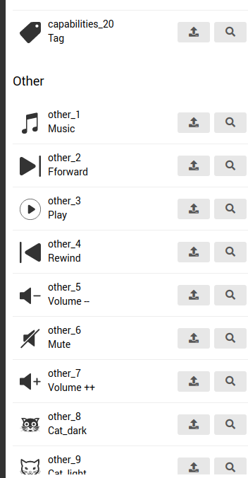

Hey Arie,
FYI, I added icon descriptions, and added some “Other” category icons as well.
But the “Customized Icon Names” list (of the Device Settings) stays empty (both web and mobile app). App was restarted and Homey as well.
