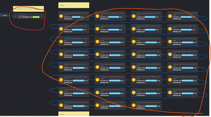

I was making a few small scripts for AMS reader http call, Instead of a large Flow like in this pictures
Script Monthplot

This script instead of all this flow cards (only half of them in this pic)
6 small scripts and this device-capabilites :smiley:

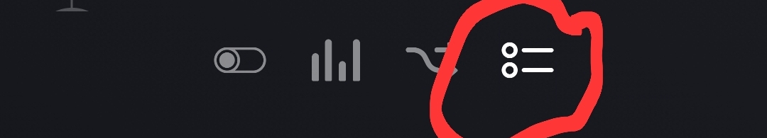

Yes/no insights are shown in the homey app, in the Device tabs.
Found it! Thanks.

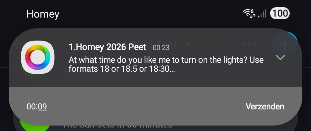

Can’t you just use the time and date from the homey self?
Timey app accepts manual entered time;

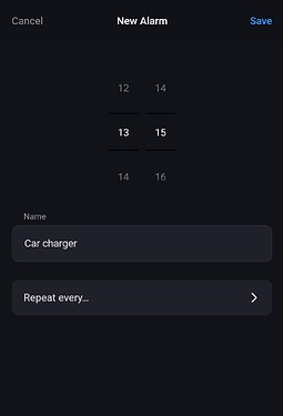

Yes I’m familiair with it. The equivalent of the time&date helper would be Homey Alarms. It’s only adjustable per mobile app.
But these can’t be adjusted with flows.
Without selecting (a) recurring day(s), it’s a one off trigger
Flowcards: enable/disable [alarm], and enable/disable next alarm
