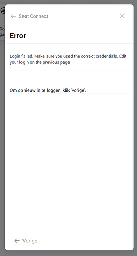

I can’t add my Seat Leon anymore.
I used to have it connected, it still works in HomeAssistant.
Verified my username and password by logging out of the Seat Connect app (on my Android phone) and logging back in again.
So I know for sure it’s the right credentials.
Anything I did?
@Robin_van_Kekem yeah lots of updates in the API lately.
Home-assistant uses a different library…
But for cupra / seat Read from here :slight_smile: [APP][Pro] We Connect / myAudi / MyŠKODA / My SEAT / My Cupra - #1830 by Ronald_den_Otter

I am suspecting something changed again at VW id side. The homeassistant stuff doesn’t work anymore. Can’t find VIN id anymore. Did you notice this also on Homey?
@Ronald_den_Otter which app version are you on?
Same with my passat …
@Marc_Jurriens which app version are you on?
I tried both
Still same test version. 1.18.3 Test cupraconnect.
