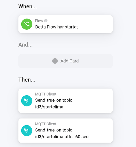

May I ask you how your action card looks like when you send the “true” value to iobroker, which will/should result in the start of the preheater?!
https://homey.app/f/n3ut9M
I actually start the heating twice to make sure
Damn you’re quick!
But yeah, it looks pretty much as my setup:
Pretty weird, the flow is working and the value is changed to “true” in iobroker. But preheating will not start. But as I said, if I change manually it works fine.
I really hope @martijnpoppen get’s his ID.X soon. :wink:
I don’t think the problem is in the Homey end because you said that the value changes in the IObroker end. Strange.

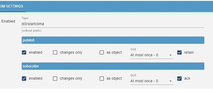

Here are my setting in the IObroker end. And you are writing to the remote.climatisation point in the IObroker?
Sure thing!
I have checked the retain box, but I did it today in order to test if that was the issue.
Sorry, can’t help you more. Strange that it doesn’t work.
