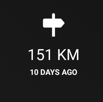

Just Hybrid , right… for eGolf it’s not working last 10 days, not sure I shall keep sending logs.

Seems like every model has a different way of sending the range. so made a fix for T-roc which bricked the GTE and E-Golf. Newer models are setup different. So made some fallback for these weird types
:thinking:
@Sharkys let me know if the range works for you. according to the iobroker dump I got from you it should work again :crossed_fingers:
