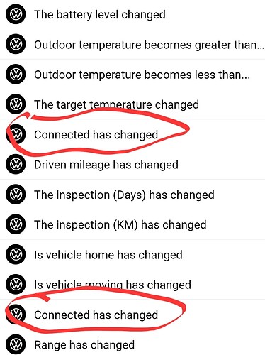

Thank you - I have the trigger without condition, so no idea why it doesn’t - also not sure if thats a glitch (1st Connected is Data connection, 2nd is Plug connected maybe?)
Thanks

The action card if “connected has changed” does not seem to run when the charging socket is connected. I have tried both of them :wink:
The and card stating the “socket is connected” does work.

  • FIX: Connected has changed text @Sharkys
