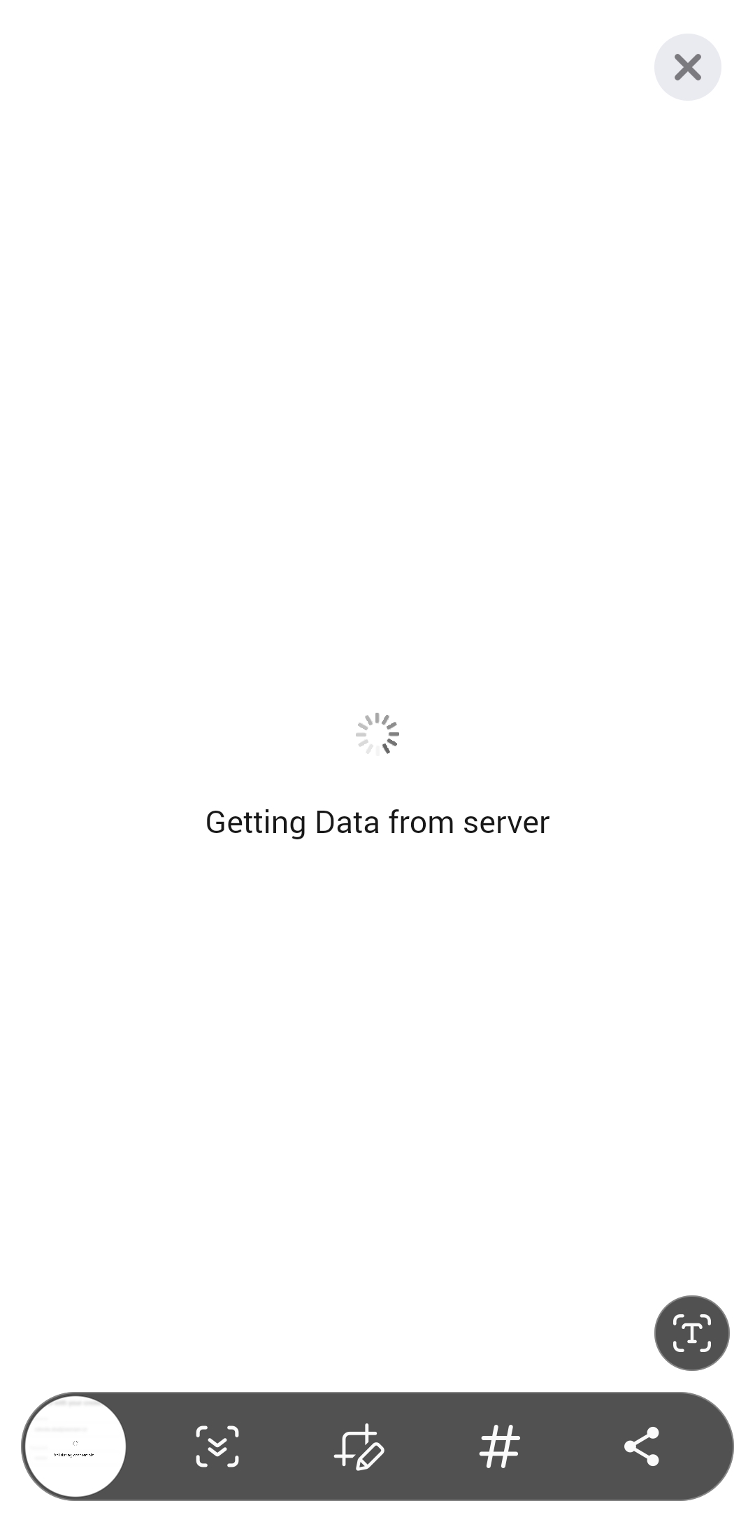

Hello, I have a problem with Cupra connect app…I can’t add a new Cupra Leon vehicle to Homey. When filling in the login and password and connecting to the server, it says an error. When I checked the app connection in the app settings, it listed the API data. Can you please advise? Thanks a lot.
