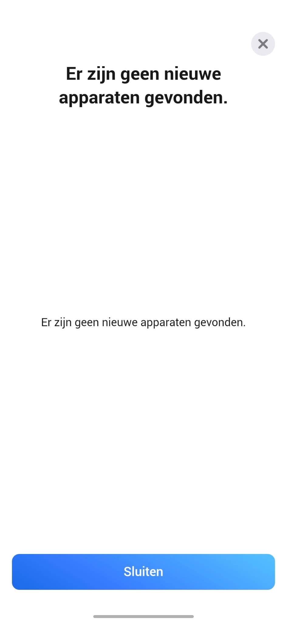

New report;
c7c91d34-fa35-4281-94c9-870285d76ac8
The only change is that my phone does not say ‘error’ anymore but now it says:
No new devices found
@Nick_M not much to see, but what i can see is that the car really can’t be found.
