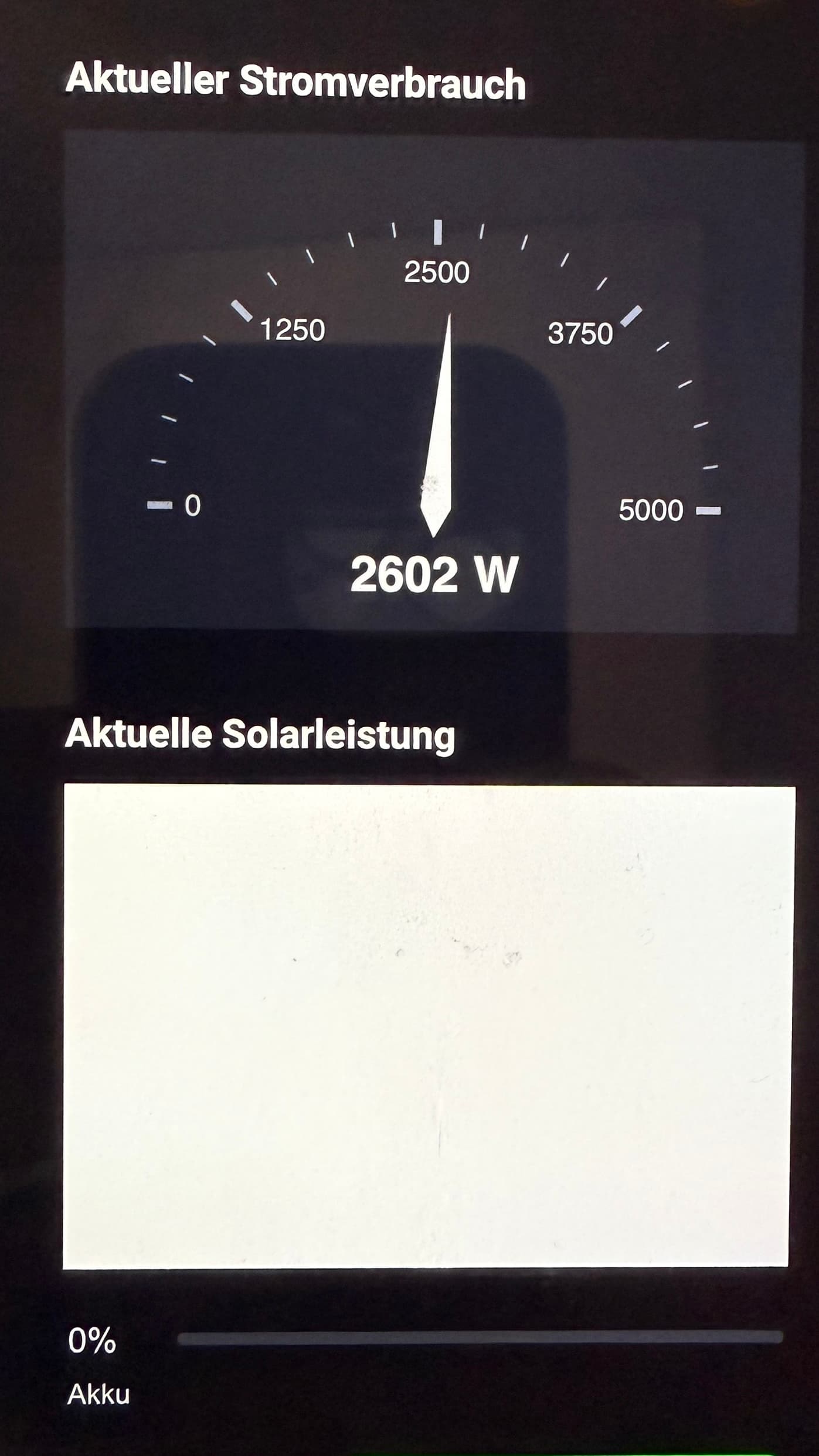

Hi, i often have at my Tablet the following view: a white Spot :sad_but_relieved_face:
Any idea?
Hi good morning @Erikvl87 brilliant app. Using datavista is homey pro 2019 in a dashboard. Since a few weeks the loading wheels are only spinning. Restarted everything homey, removed datavista app reboot iPad running on iOS 16 latest and still spinning wheels showing and not able to show them anymore. IPad pro is works so is there someone who can assist me getting this working again?
Thanks.

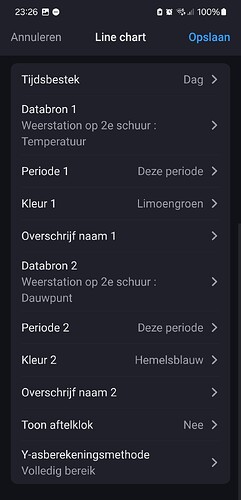

i read the last i guess 100 post of this topic and i look very promising, but when i instal the app and try to make a Graph on mijn dashboard, then there wil be a empty plot.
i read how i need to set up the app, and if i understand it the right way then i don’t have to set upp anything if i want to make a line Graph. ore did i mis something?
Did you select the data sources in widget settings? Please check the very nice documentation:
Thanks for the respond, i did check it and i think i did everything the right way. But the change is great it is mijn lack of experience that is doesn’t work.
As example
Examples of data source selection (it can take a while for the data to appear),
filtered on “solar”:
filtered on “battery”:
Result:
I think i did it the right way.
Maby i am not patient enough, lets wait til tomorow before i make changes again
Looking good.
The graph should appear shortly after saving these settings.
Did you also try with values from a different device?
Just tried with other devices, that did not make a diference.

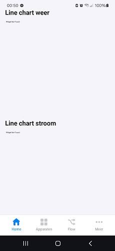

But when i turnt of dark mode of my phone to chech if that sas te problem. i saw the notification: widget not found
Ah… Maybe installing the app again from the app store makes a difference (no need to uninstall first).
If not, restart Homey.
“Widget Not Found” looks like some installation issue. Like @Peter_Kawa advised, could you try to restart Homey or reinstall the DataVista app?
