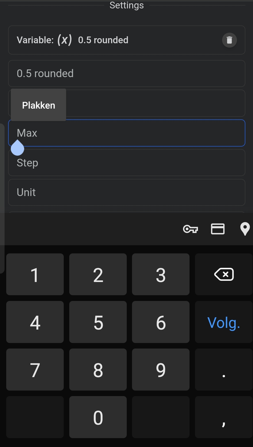

@skogsaas can you add the possibility to use negative numbers for minimum and maximum value at numeric variable settings? :innocent: :pray:

Nope, only numeric characters can be entered, so no minus sign…… :grin:

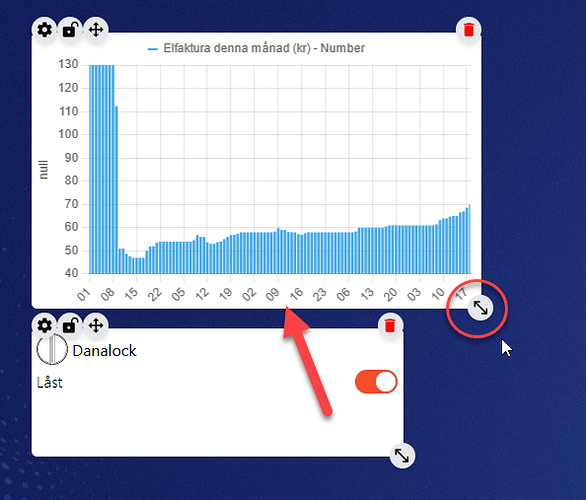

  1. Added my first Insight. As you can see on the screenshot above, we have dates on the X axis as we should have. When I try to increase the width, suddenly the dates on the X axis are replaced with…time I guess? Seems to be a bug.
Not related to homeyboard dash,
this is about your keyboard… :wink:
Fix: I once installed an alternative keyboard, which has a minus sign on the numeric keyboard, which is lacking on the standard numeric keyboard.
Workaround, when installing a keyboard is not possible:
Enter for instance -65 in a text editor (so you can use the regular keyboard), and copy paste it into the numeric field
@Peter_Kawa, I’m totally stunned…. how can it be this simple and how do you know this…. :exploding_head:
Thank you for this hint and helping me out :clap::+1:t2:that did it :grinning_face:
Haha, thanks.
I learned this while I couldn’t enter a negative temperature in a virtual thermostat’s temperature range.
Someone in the Virtual Devices topic hinted the copy paste workaround:
Later on I found out by coincidence, my alternative keyboard happened to have a minus sign on the numeric keyboard.

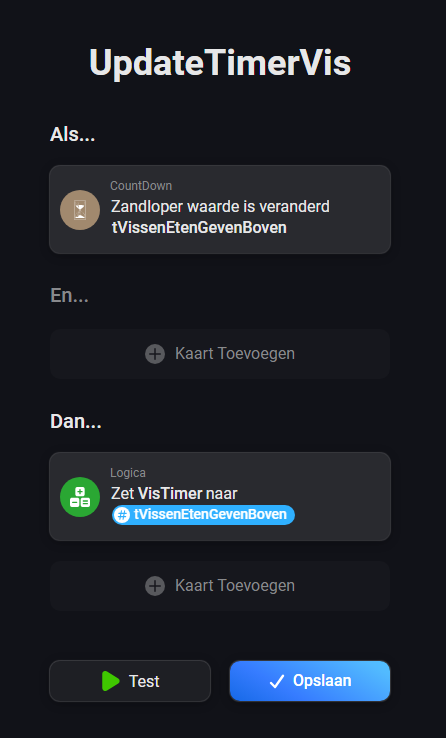

Does anyone know of way to add timers from the countdown app ?
Perhaps it works by adding a variable for every timer and update the variables every few seconds to match the timer and then add the variable to the dashboard.
EDIT: I can confirm you can update a variable by matching it to the countdown timer to show the variable on the dashboard by creating a flow to do this.
