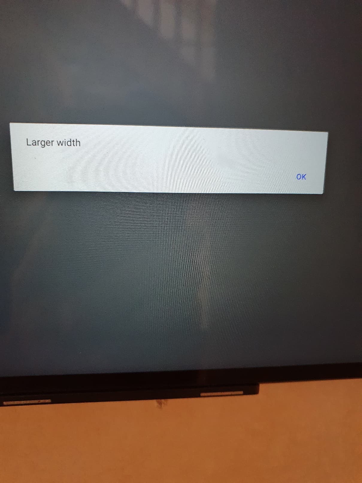

Since yesterday I get this popup shown below on all my Android dashboards when it should show an image from one of the cameras, and it is the same for Onvif and Eufy cameras.
And after that this popup
Is it just me, or does someone know what to do?
Dashboard controller v0.3.2, updated yesterday
Homey v8.01
Thanks in advance!
I’m getting it aswell. Hopefully just a bug :blush:
Sorry guys, so unfortunately I accidentally committed some debug code for an upcoming fix for an issue to the main branch and thus it was released in the latest 0.3.2 version. I’ve just released a new version what should fix this in 0.3.3.
Thanks, that was a quick fix!
Now it works again. :slight_smile:
