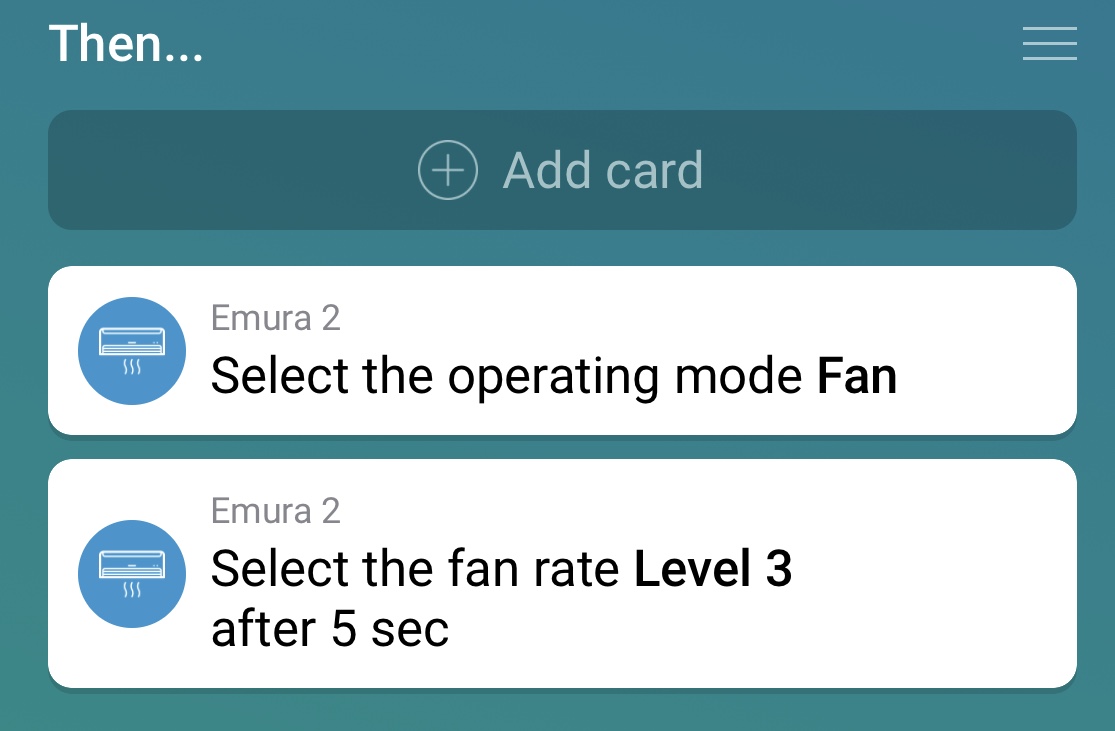

I get the fan speed not working in a flow with version 3.4.1
@Rudy_P Share flow please, its working fine with my own flows and v3.4.1.
A sample flow
https://homey.app/f/eU8Dff
When the airco is off you should first turn it on, otherwise it will only change fan speed to 3 but nothing else will happen.
Do it like…
The airco is already on. Fan speed must change by 23 degrees
Special modes enabled? Upgrading from a old to new drivers/flow cards? If so delete app start over, see issue Viktor had.
I changed the flow to:
https://homey.app/f/9crRff
Now it works.
Aha, I see what you mean…
I was focused on the action not your trigger condition, my wrong. You did find a bug thanks for reporting, will try to fix it in version 4.x.x.
Rudy, this afternoon I was looking into this issue and on 2nd thoughts I don’t think there is a bug, let me explain…
When trying to reproduce this issue I thought wait a minute this is a trigger card not a condition card… The trigger card you use will trigger ONLY when the inside temperature changes, in your case from 22 to 23 degC, but also from 23 to 24, from 24 to 25 etc.
I created a flow card like yours… cooled down the room to below 23 degC then put the airco’s target temp to 24 and waited… the moment the inside temperature changed from 22 to 23 my flow triggered and changed the fan rate.
