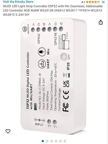

I Turned that setting off and now the issue is that is randomly turning off. Today I received yet another one that I ordered online and i did not add that one to homey and its still doing the same thing so it seems that its an issue with those controllers. I am using these ready to go esp32 controllers I bought on amazon, kinda regret it now.
That is interesting. Good to know. I got one of those laying around here too but I didnât get around to test it yet.
