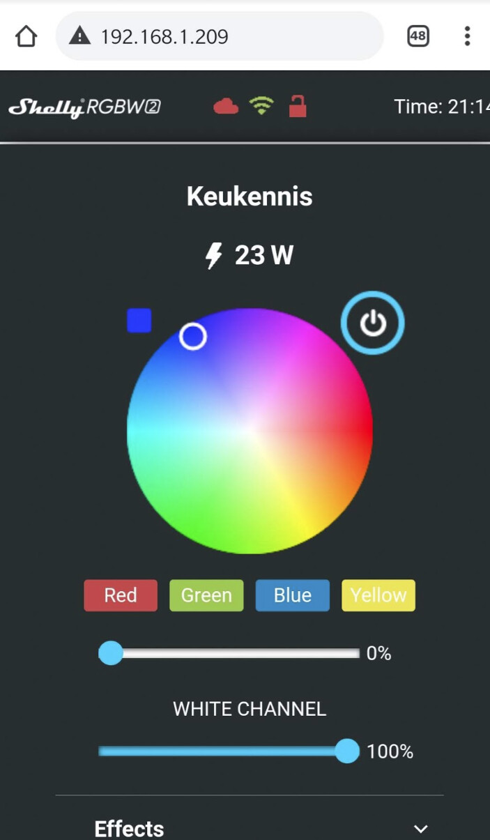

I’m having this issue with a Shelly RGWB2, which has a 2m dual white (warm/coolwhite) ledstrip attached.
  • WW is attached to white channel
  • I think CW is attached to blue channel
To dim the strip when it’s in warmwhite mode I need to adjust the temperature in Homey. (The homey dimming control seems to control the Shelly “gain” control (in Shelly UI), which controls the cool white channel)

fyi, in Shelly UI it’s like this
Any tips?
I’ll fix the missing light_mode capability error in the next release which will also fix the flipping between the color and temperature wheel in the app. No tips about all the other stuff, not sure if that setup is supported and the RGBW2 driver is configured to support RGBW strips.
