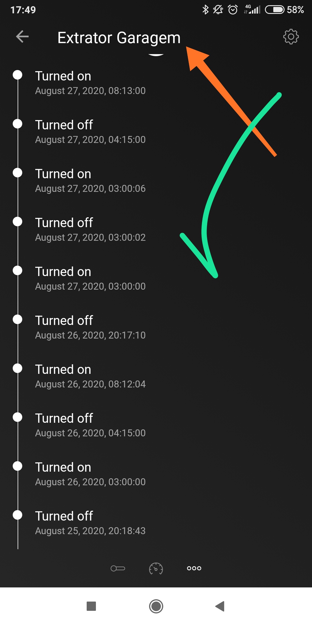

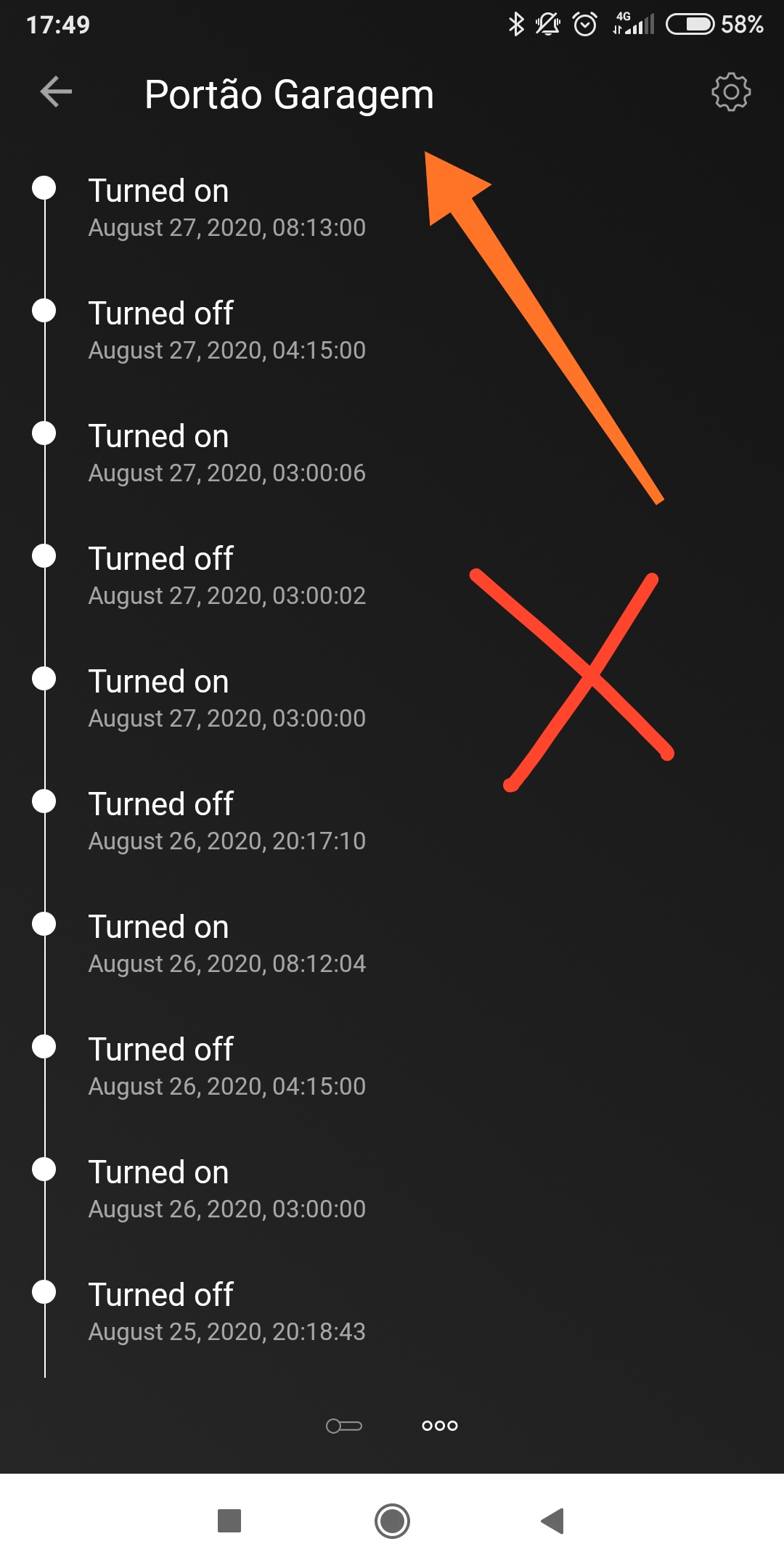

I noticed i have one device (shelly1) that is registering the entries of another Shelly device (Shelly 2.5) Only the second relay entries.
The shelly 2.5 - relay 1 is connected to a bulb. (This one is not related with this mather)
The shelly 2.5 - relay 2 is connected to a air extractor.
The Shelly 1 is connected to my garage door on a 12v power, to open and close door.
What happens is that the shelly1 (garage door) is registering all the entries from the Shelly 2.5 relay 2 (air extractor) .
They are different devices with different IP can’t understand why this happens, is not a huge problem, is just that the shelly1 log is incorrect.
If possible i would like to fix it.
Last time i used the Shelly1 was 4 days ago, but it has logs from today, cause the air extractor is on and off based on schedule everyday.
Is it just the log out is it also responding to actions of another device?
Just the log, it does not take actions.
That is something out of my hands, seems like a bug in Homey core which you should report to Athom.

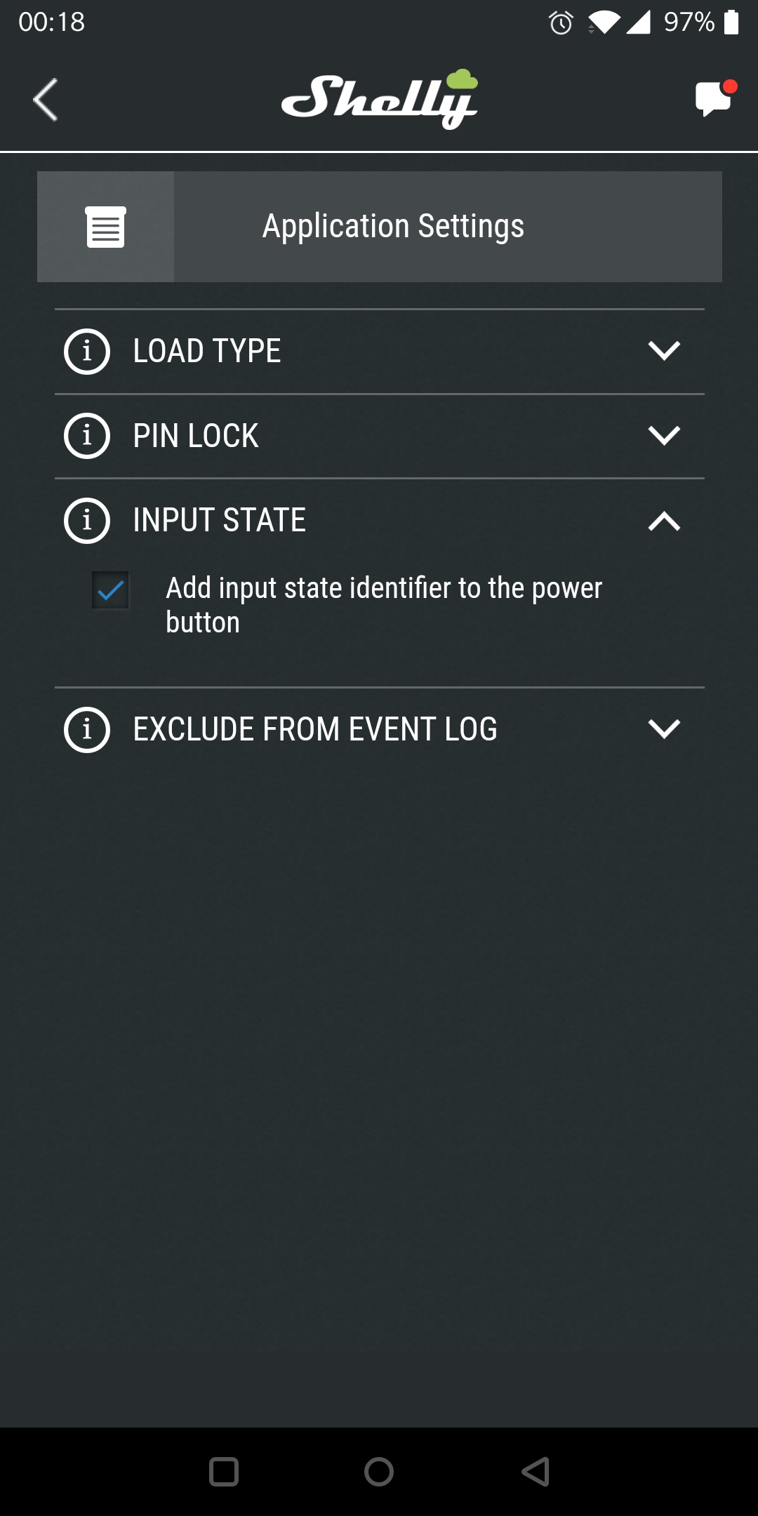

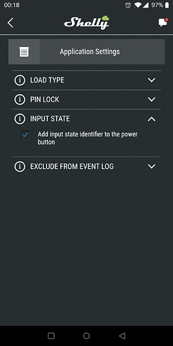

It would be great being able tot see the input state on the SW input of the Shelly 1 in the Homey app. EG ‘switch position is open/closed’
I want to use that state in a logic variable in Homey. You can activate that functionality in the Shelly app as in the print screen below. Hope my explanation is a bit clear
This information is not available in the REST API, I cant do anything with it.
