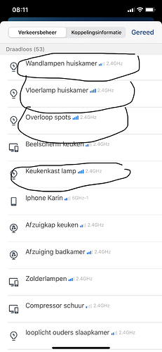

Have you assigned static IP addresses in your router for your Shelly devices. My guess is that their IP addresses changed. You can check this by comparing the IP address from the device settings with the IP address in your router.
all ip addresses are fixed to me in the router from installation
The above screenshot does not tell anything about fixed IPâs but Iâll believe your word for it. Could you restart the app and then send me a diagnostic report after one minute.
