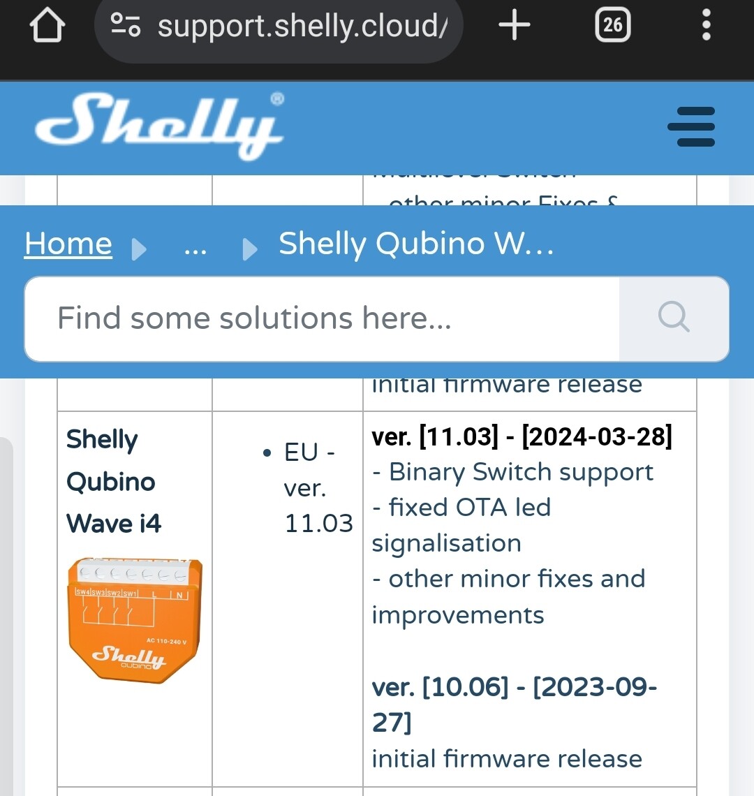

I need to call up scenes with 4 buttons. I read about Shelly PLUS I4 and that the Z-Wave version does not work properly if it has older software. Is it better to choose the WiFi version? Can this device receive single or double button clicks? Sorry for the question
Initial firmware of the Shelly Wave i4 has an issue with updating the inputs (binary switch), see known issues in the first post. You will not be affected by it if you will be using it with buttons. Both WiFi and Z-Wave version are able to register various button events like single, double, triple and long press.
Thank you, so if I understand correctly, regardless of the version of Z-Wave vs wifi, if I connect the Shelly i4 to the button, Homey will detect these clicks without any problems or delays?
