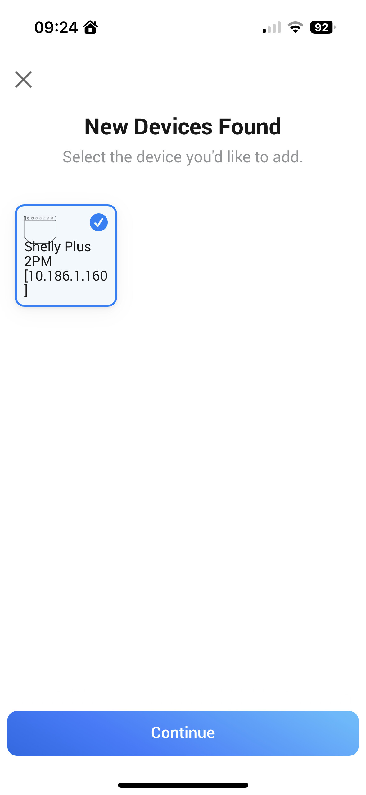

I’m trying to add to Homey Pro 2019 an Shelly Plus H&T the temp and humidity sensor with the screen I’ve just buyed.
But I’m having trouble, Homey detects the device but after the choose the logo screen it just stucks frozen - this happens disregard of using the normal ou a costumized logo.
I’ve just added a few days ago a Shelly Pro 1PM without problem. Can anyone help with this sensor?
