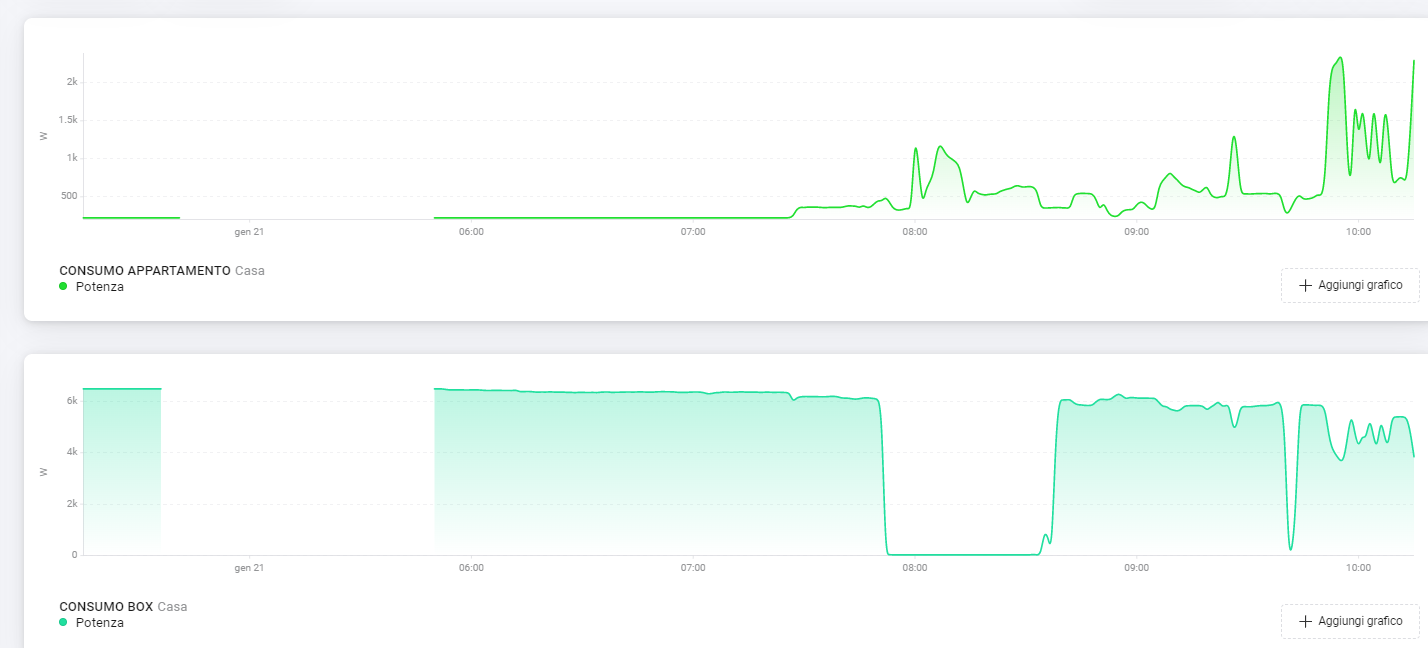

@Phuturist hello, I have a problem with two SHELLY EM. I use them to keep undercontrol the garage and apartment consumption. Specifically a flow defines the maximum Ampere my tesla can adsorb considering the total consumption of my house and the maximum power available from the provider. It happened, twice already, during night, at 3 and at 4 am, that both shelly EM (in homey, not in the shelly app), stopped updating the power and of course this led to over absorption and the current provider cut the electricity. I managed to have the shelly measuring again after restarting shelly app in homey.
In the picture you can see the power consumption that becomes flat and than after 3 hours the electricity provider cut the service.
I doubt that this is caused by the Shelly app, it’s more likely caused by Homey’s quite unstable networking (which also causes issues for other apps). I wouldn’t trust Homey for anything like this.
Could be two things. Like Robert mentions above, it could be the network stack from Homey causing issues. As this seems to be an issue for more apps I wouldn’t recommend such vital flows like yours on Homey. It’s not something I can fix.
Another possible cause could the the memory leak that is still present somewhere in the app and affects some users. You can see this under app memory usage of your Insights page. If you see a steady rising line here it is. If that is the case, do you have more Shelly devices that might be causing reconnect issues. This seems to contribute to the memory leak.
Thanks for your fast feedback. I’ll give a look at it. I have many shally devices.
