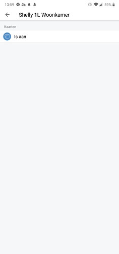

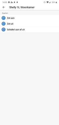

Those are trigger cards. Show me the list of condition and action cards.
Interersting, itâs missing a lot more flow cards that might not show due to a matching mismatch of driver name. I accidently name it shelly1L with a capital L and reference it with as shelly1l (with lowecase L). Could be that this is causing issues. Need to look into it. Dont have a Shelly 1L to test with though.
Iâll probably fix it with the next release.
Sure, no rush. If I need to test anything just let me know.

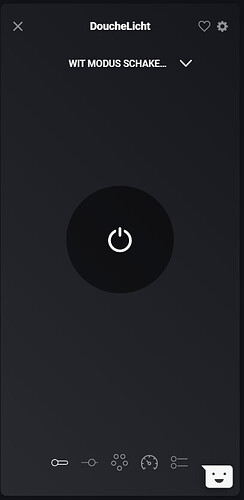

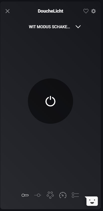

Could you check the settings to see if itâs in color mode?
I think both are, when I select âswitch white modeâ itâs off
But I must say I find the white mode and color controls on Homey side a bit confusing with regard to how the controls work in SHelly UI. When I check Shelly UI both are 100% channel 4 (ww) and 0% on RGB
Also, when I turn them on through Shelly UI the correct state is represented in Homey Shelly (on/off), so itâs communicating, just any control gives the error
Please check the color mode under the Shelly settings through the webinterface of your Shelly RGBW2. There is probably a bug in 3.0.44 which set that to white mode while itâs paired as color and visa versa. That could couse the issue. If you have confirmed that I will push 3.0.45 to live which fixes that.
Seems to be it!
Both where in 4xwhite mode in Shelly settings (looking back at the screenshot kinda obvious with the 4 sliders but iets been al long that i have been in the Shelly ui IT didnât catch my attention)
Now that i put them in color mode they work again in 3.0.45
