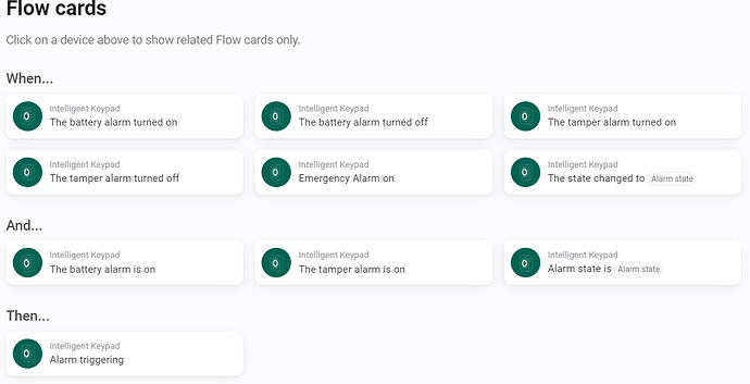

THANKS,
Ok for the possibility of adding several RFID TAGs.
What are all the flow options with the Frient keyboard?
Can you post a screenshot?

Of course, you can always see the available flows for each of our devices on our app’s page, and after selecting the desired product from “Supported devices”: frient App for Homey | Homey
Here’s the screenshot you requested:
Good morning,
The available flows for each device is not necessarily representative of all product features.
For example, the fibaro keyfob remote control (6 buttons) allows in its configuration menu to program for each button an action in case of pressure (1 pressure, 2 pressure, 3 pressure, long pressure) and 6 buttons combination sequences (1 to 5 buttons in a row).
Can your Frient keyboard do this type of action?
I’m afraid you cannot have exclusive control over each of the Keypad’s buttons at the moment.
The idea behind the frient Intelligent Keypad is the secure access control and keyless entry, as the device allows you to trigger certain actions with its modes - armed, disarmed, home, and night, similar to other control panels.
I think that to make your keyboard attractive it would be necessary to implement the possibility of creating actions with sequences of the type as proposed by Fibabaro keyfob or Ring keypad: several presses on the same key, long press on the same key and key sequences.
With these additions your keyboard could become a reference for use on Homey.
It is possible in the near future?
Thanks for your valuable feedback. We do not exclude any possibility for future updates.
